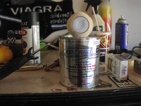

Step 1- Buy the product (took two days to arrive)
Step 2- Remove any flakey stuff with a wire wheel
Step 3- Stir and apply ( I used a three inch roller with 1/4 inch synthetic fiber)
Step 4- After your second coat, bake in the sun...(not sure if you can see the sign in the background, but it is showing 100 degrees)
I then painted over it (for now) with some Krylon Semi Flat Black...
