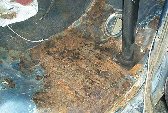

Here's the before pic. I ran the floor over with a wire wheel and wiped and vac'd the dust out.
Here's the floor lined with rust bullet. This stuff really spreads out nice. One small can is enough to do both floorboards twice. primary and second coat per instructions.
Here's the floor with the roll in bedliner I bought. I did two coats here as well.
Check out the snazy floor mats my wife bought me for christmas! :thumbup
This was real plain and simple. Getting years of dirt and crap was the hardest part. Rust bullets instructions say it doesn't even require any prep but I did some anyway.

It is an install though. I just put it there because some peeps said they wanted to see how it turned out.
