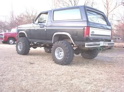

Two days of vacation and $275 well spent. The steering and track bar came out real good with no noticable shakes or shimmies. Came out w/ about 8" of lift and drives like a dream. I haven't got to flex it out yet, it's only been done for about two hours...and I'm friggen sore and exhausted. I'm so stoked:rockon :rockon :rockon Driving in town the truck feels alot more responsive steering, overall just feels alot more solid. We pieced it together using my '85 stuff and two junk '78s, and made everything else. My buddy owns a racecar fab shop and helped me more than he had to, not to mention I tied up his lift for two days. I had a killer fabricator, plasma, mig, tig, lift, free reighn of two '78s to steal shit off of....Awesome time//////\Thanks Kevin at Copeland Racecars :rockon :rockon :rockon :rockon :rockon
I just snapped a few pics, I need to clean up a few welds and clean up ALOT of grime before I get good pics, but here's a few:chili:
Cut the other to match and made plates to mount them on. I'll get pics when it's light outside. Just got back from a drive, took it up to 80mph and all feels good. My ttb was responsible for alot of rattles too, all you here is boggers now.:thumbup I got some ttb lift brackets cheap if any one wants them?
The nine inch in the rear is plenty stout, the back already has an add a leaf and 3" rear block. It had a jacked up rake to it before the SAS, it sits almost level now.

Here's some more pics:
I retained the rough country 6" drop brackets moved back 9". I may change these out for stock brackets w/ 7 degree C bushings though.
Here's my track bar mount, it's the '78 mount cut way down.
Used ttb springs mounted on the '78 buckets. Used 1/4 wall square tubing for a little extra lift. I may change this too if I can get my new bff Lightnin to make me some of those bitchin spring to knuckle adapters:thumbup
Flipped the '78 trackbar upside down, and built a custom tie rod end/ draglink out of assorted bronco tie rod ends (one off a '67 bronco too) and DOM tubing.
If your using TTB uppers and you have those llowers on now is your axle centered in the wheel well? Shoot me a side pic if you have a chance. I would like to see the shock, coil and wheel placement.
