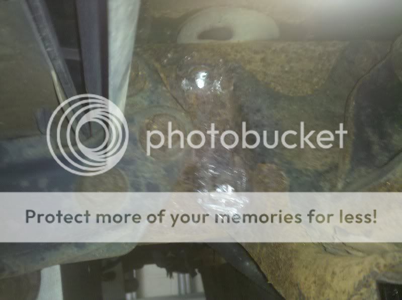

i need to reuse these brackets, i got half of a head off but jeez this really sucks
this is as far as i got, i cut my hand open today so i'll go back tomorrow... I have the shocks unbolted but i cant get the pass side off the top stud :/

OMG thats is the whole problem. Get a real grinder and it will take you 5 min per rivet. I was wondering why when you posted that pic It looked like nothing was done to it after all that time grinding.:doh0715: It will take you a week to do it with a dremel disk.
