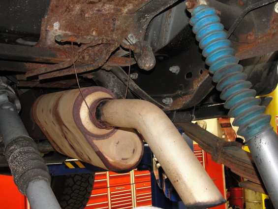

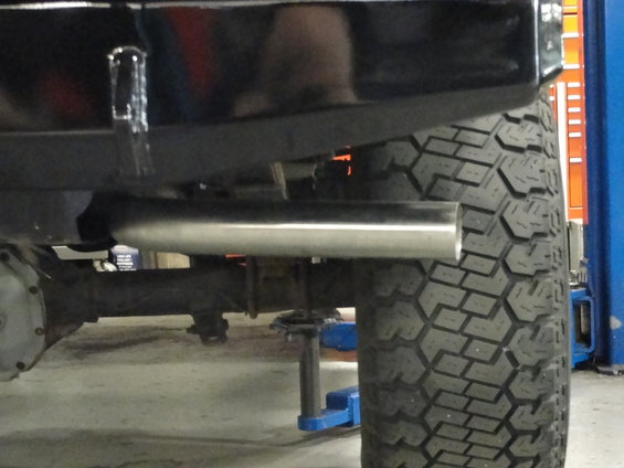

So to start i did a full exhaust system a few weeks ago, Bassana Y pipe, Magnaflow cat, Hooked aero chamber muffler and a magnaflow 13005 3" tail pipe.
The awesome muffler i had on before.
And the new stuff all stainless steel.
