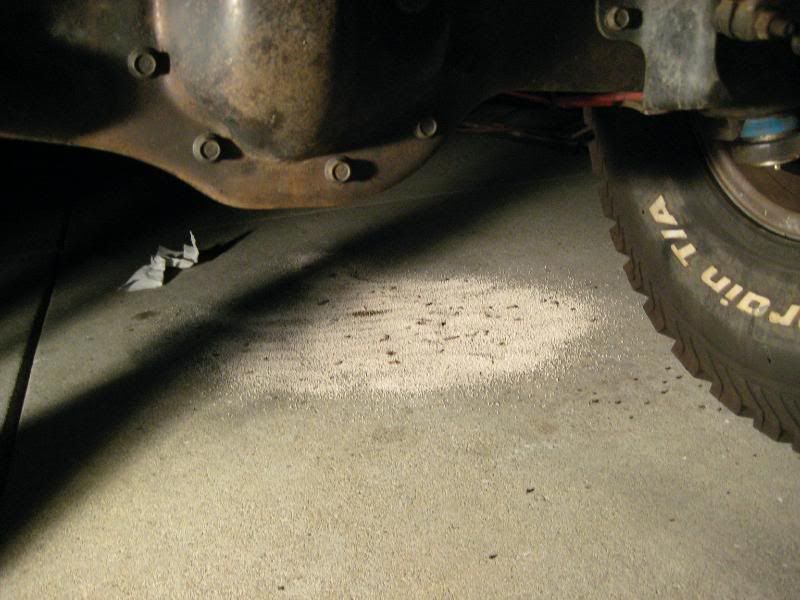

1. Pull that big 'ol honky tonky thing in the driveway or shop.
2. Lift 'er up! Safely support the truck with jack STANDS and not the hydraulic jack itself.
