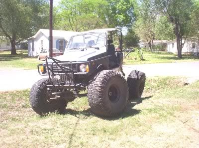

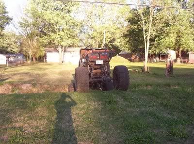

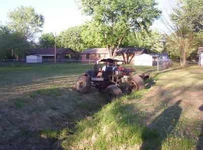

Couldn't go wheeling this weekend so I played some in the yard :thumbup
Took it thru the drive thru at McDonalds too, the look on the chicks face was priceless :toothless
I promise some retarded wheeling pics next weekend :rockon

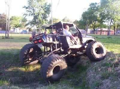

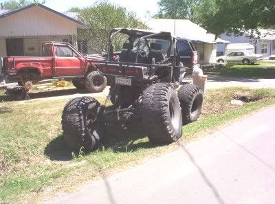

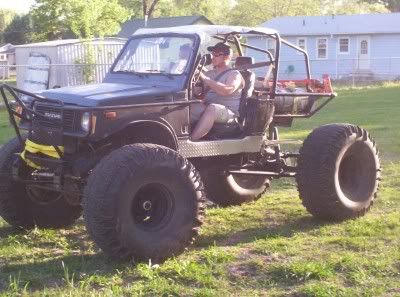

You flexy bastard. Can't quite tell from the pics, does that rear have the 1/2 leaf pack elliptical style spring setup?
1,402 Posts
Discussion Starter · #6 ·
Yep, elliptical w/ a 4 link. The trailer jacks welded above them let me pre-load them, I can raise or lower ride height 14". I'm yanking the trailer jacks in favor of airbags left over from the mini truck days.

do you have any pictures of the front linkage system?
