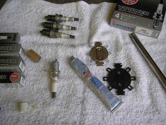

When reinstalling, always use Dielectric Grease to prevent heat from causing the boots to stick to the spark plug insulator (porcelain). The photo below may appear to be an over use of Dielectric Grease, but it is actually a small amount at the mouth of the boot. This will self-spread upon twisting the boot when installing.
