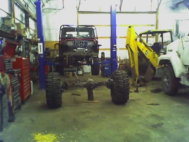

started linking the scary jeep.
need to hurry up and work my as off on it so i get it off my hoist as soon as possible, as my side work usually requires it, and thats what makes me the $$ for this expensive hobby i have.
3 link front, triangulated 4 link rear.
front is getting another 3" of WB, so total WB will end up at 106", damm near perfect bronco WB

well, jeep sat all sun and monday, just got back form a snowbaord trip, so back to work on it tommrow night.
4.0 fuel injected, 5 speed, dana 300 thats geared, twinsticked, and flipped, mog 404's, 40" boggers, on usa 6x6 double beadlocks.
plan of action is TJ sized 5-6 inch lift coils on the front, and not shure on the rear yet, possibly coilvers do to frame interferrance for fitting an outboarded loarge coil, and not enough clearence under the frame for a inboardred coil. might notch and narrow the rear rail, but that will take a decent amount of rear fab work to reattach the body, bumpers, and crossmembers.
my plan is to have 14" of travel at each corner at the shocks.
my 4 link is gonna be odd though, dont even plan on removing the tries at all during the build! may have to take the rears off though to fix the rear shitty brakes. has drums, for now and a while till i recoupe more $$. 3 trail only rigs make me go broke.

front links on, and good!!!
need 14" shocks, 22" limit straps, and 3 bumpstops. 2 6" ones for under the frame rails, and heavy one under the grill to stop the axle from smacking th eoil pan in case of wheelies. as the upper links and there mounts will want to wipe out the harmonic balancer, and the starter if it where to bottom straight out! im gonna build a large bracket on the frotn of the pumpkin for a heavy non coolapsible bumpstop to hit just before it would smash those things.
all i need to do is final welding on the axle links, and to gusset both upper links, and to box in my uppper truss on monday.
