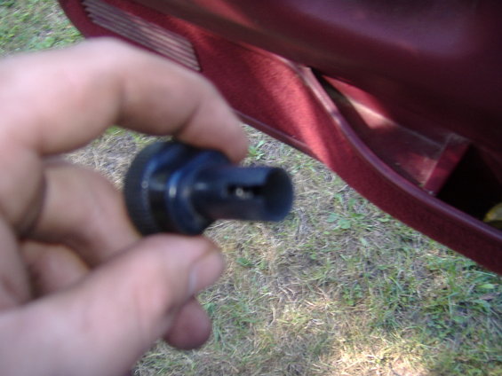

Dental picks:
The one my finger is on (90* bend) is what I used.

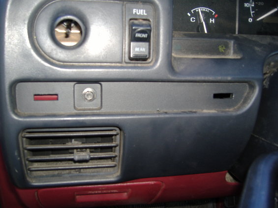

Carefully remove the dash bezel/trim by popping it off. Work your way around and work it up and off of the steering column.
The lower dash piece is also held on by two screws, each on the lower corners. Carefully remove that piece as well.

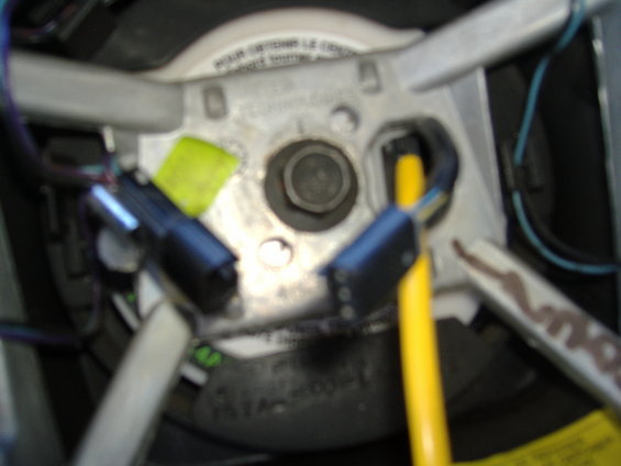

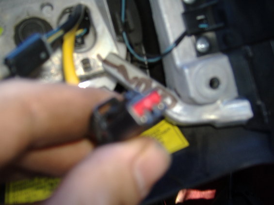

Next, remove the airbag by removing 4 nuts. These are located on the backside of the steering column.
Carefully remove the airbag and disconnect the power feed, and set it aside.

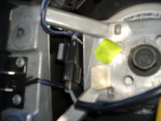

The connector with the bright yellow is for the airbag:
Now disconnect the horn connection:

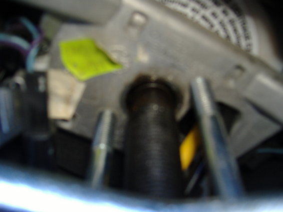

To remove the steering wheel, loosen and remove the bolt.
Find the correct bolts to fit into the two threaded holes meant for using the steering wheel puller. Puller setup:
Tighten the steering wheel puller and the steering wheel should come of with little effort. Be careful to feed the wires and connections threw the steering wheel

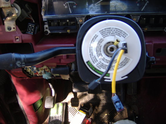

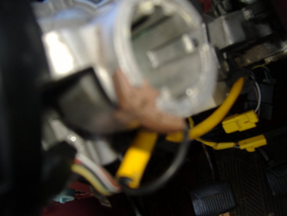

After the covers are removed, the clock-spring needs to be removed. For my year/setup, there where 3 places that the plastic clips onto the metal tilt piece of the column. Carefully pull/pry on them and it should pop freely off. You will also have to remove the brown plastic piece seen here at the key cylinder:
Along with these connections on the lower part of the column and the clips that hold the wiring harness to the steering column body.

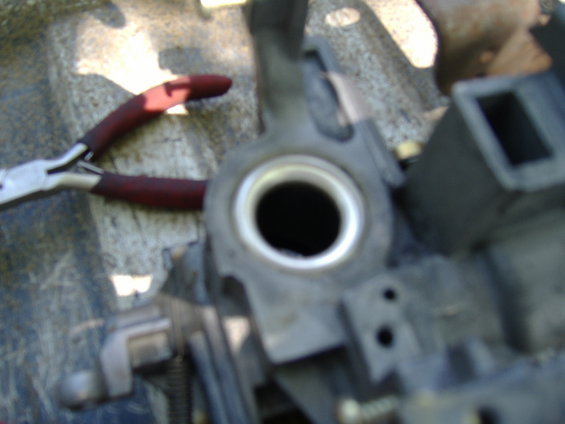

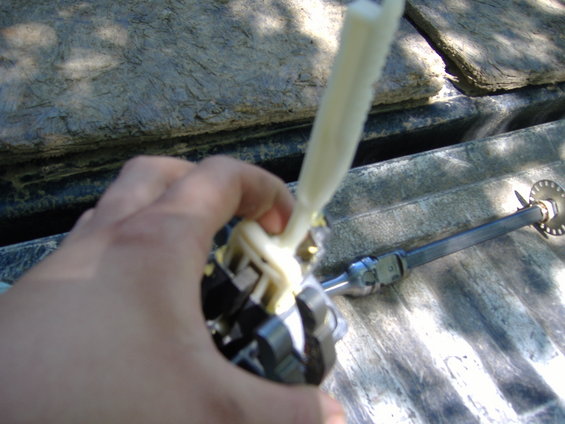

The next to last setup is to remove some of the pieces from inside the column where the key cylinder inserts:
Using a dental pick, as gently as possible, you have to get behind the green piece of plastic and pry it out. It has little “hooks” that clip around the piece behind it, but you cannot rotate the metal piece behind it without removing this green piece.
Pry carefully, and it should come out.
Then the metal piece behind it, when removing it, note which way it was removed. Otherwise it’ll cause you headaches later.
Then the gear behind that. Note its position as well.

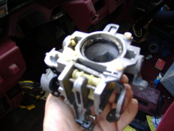

Now for the dangerous part, the tilt spring. This spring is located on the right hand side of the column…I am not sure on the actual method for removal, so you’re on your own, however, I will explain how I removed it…
Using a large screwdriver, pry the spring out of place, it will take some effort, and watch out, it goes flying!!! When I re-installed the column, I attempted to put the spring back it, but failed to multiple times. I just left it out, as all it does is help push the column up when the tilt lever is released…you will have to be the spring if you cant put it back in, but the column will still tilt. ;)
To remove the tilt part of the column from the main body, you need to remove two torx on each side of the column assembly. I couldn’t get a ratchet in, and my screwdriver handled torx wouldn’t allow me to get on straight, so I used a wrench and socket together like such:
Then you will have to fight the jaws on the underside of the column to remove the tilt piece. You will be left with this:

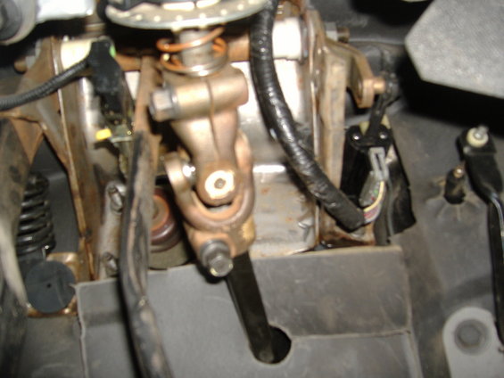

With that removed, you can move on to the ujoint that connects right before the firewall.
I removed the ujoint with the steering column, but you don’t have to. Loosen and remove the bolt on the lower connection of the ujoint and remove it, because there is a detent in the steering shaft that the bolt slides thru. And you won’t be able to separate the shaft from the ujoint.

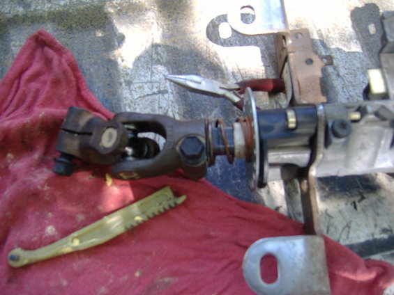

Now, on to replacing the actuators, which in my experience, the pin that connects the two popped out, which was odd because the fit of the pin was quite snug, but since I’d gone this far I was replacing them.
To remove the lower actuator, you must remove the steering shaft from the column completely. To do this, you have to remove the pieces on the lower end of the column seen here:
Just remove the ujoint, spring an assorted pieces and make note of the order. Which even if you forget, it isn’t to hard to figure out.
Then pull the shaft out from the top of the steering column. Afterwards this will allow you to remove the lower plastic actuator.

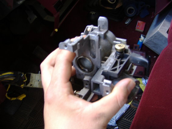

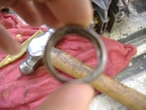

***To replace bearings in the tilt part of the column, tap the old out, and carefully install the new ones if you have to, as I did because my upper bearing was bad.***
Old bearing:
New bearing:
