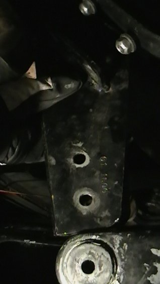

Sorry about the crappy night pics, laying on the ground, trying to hold the bracket with one hand. Take a look and tell me what you think. Any advice would be greatly appreciated.

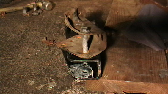

This shot is just to show I've got the old bracket and the lift bracket lined up where the axle pivot bolt goes.
See how much more room there is for the axle assembly on the original bracket.

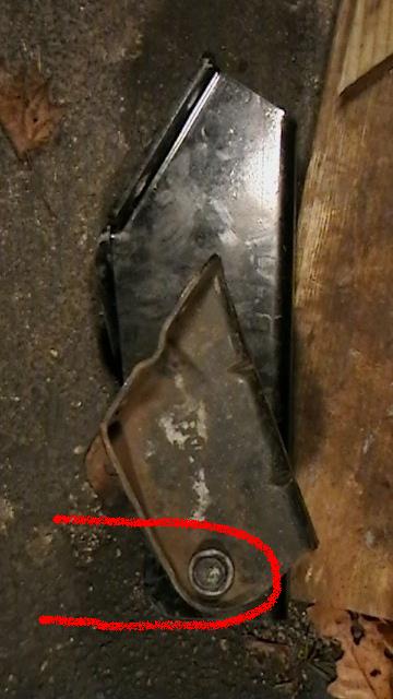

The red line shows where the axle assembly would go.
It just aint gunna go. If I raise the axle assembly up, it will hit on the end of the bracket, and the holes in the bracket will not line up with the axle pivot bushings.
The two bolts at the top of the pic are where the bracket should be mounted.

i don't know if im followin this right, but let me ask this...
if you take the drop bracket in question off the truck and attempt to put it on the axle pivot will it still not fit? like the bracket is not wide enough? if not, id send it back

Well, I run into this problem about half the time on Rough Country lift kits, where the bolt holes are not in line with the factory ones. I usually drill them out to the next larger bolt size, or slot/ream just the hole(s) that are mis-aligned. If the bracket is too narrow for the pivot arm and bushing to fit, you can either shave off a bit of the bushing inside the pivot arm, or try to bend the bracket out a bit. I also advice tack welding that drop bracket to the crossmember after it's bolted in place. There's quite a bit of stress on the arm on that side with a six inch kit. JSM84
