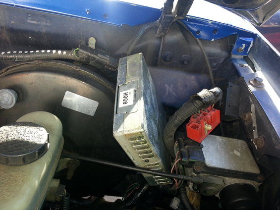

Well, I swapped in my back up EEC. Its a HOG0 same as the original. I plugged it in and drove it about 15 miles, then pulled codes both tests and got 111.
So I drove it again about 30 more miles and still 111.
I was getting a long list of codes with my old EEC and nothing so far with the other one. Transmission is still shifting like shit and sounding like shit. The engine seems to be running a little smoother.
Just wondering if the conditions that were there are still there, how long will it take for them to throw the codes again. The way its driving im amazed its not peppering me with codes.

Well now I know FOR SURE!
The old EEC was definitely bad.
You can see some rust on the case.
Inside the case it was carnage.
Burnt IC
Burnt capacitor
I am totally amazed it worked at all. No wonder I was having so many strange issues. I am just thankful I had the smart idea of looking at the EEC in the 94 junkyard bronco and then went to the trouble of getting it out. I will never pass up another one if I find one.
I just wish I had discovered this before it starved my new transmission of fluid and killed it. I suppose thats another lesson to stow away for future reference.
