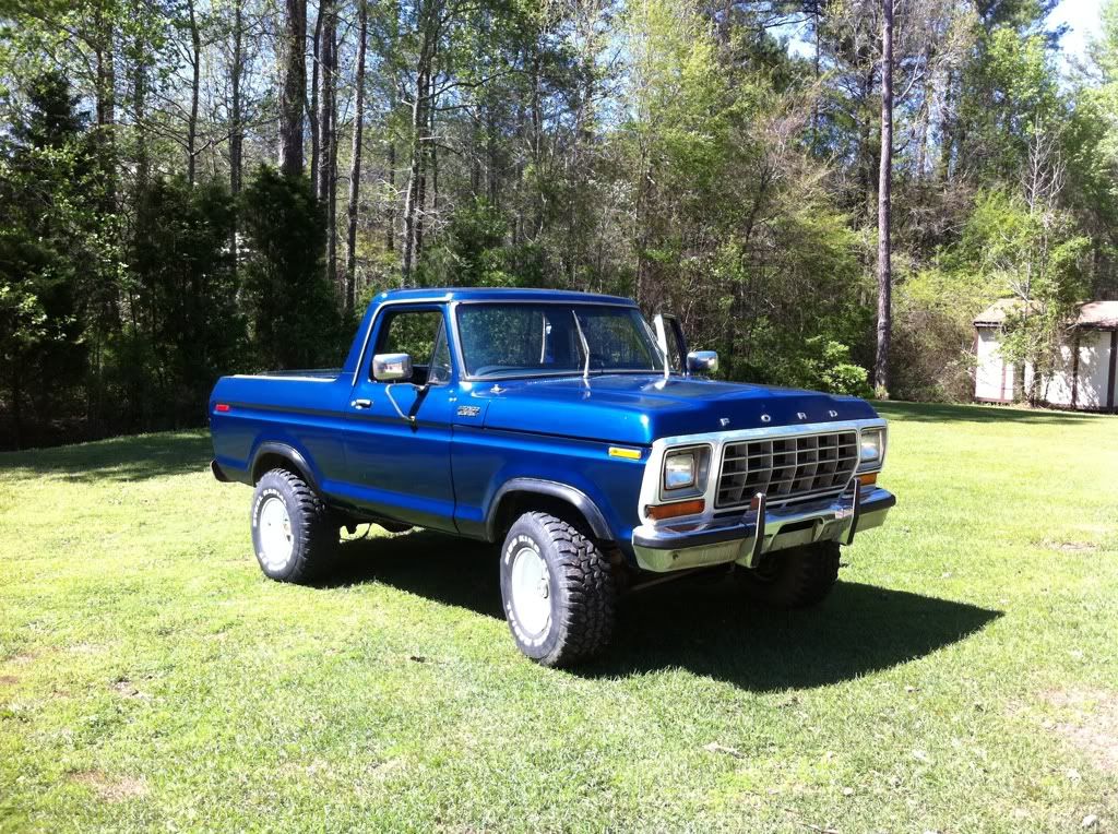

78 Bronco 351m with Granny 4 picked up for 1500.00

37" TSL Super swampers??
Those look familiar! haha
Great looking rig there brah!
OMF
2,954 Posts
38x12.5 but thanks
Measure them, they are closer to 37! they run a little small, great tires BTW, are they the radials or bias?
What are your plans? 6" lift obviously, what else?
36 Posts
Actually IDK on the lift thinking I can fit them with 4" fitting 33's with no problem now and I am not against a sawzall with some kind of flare. I am just not big on the huge lift small tire. I like a tire that fills the fenderwell but can get stuck up in it as well. It is what I have done with all of my other projects in the past.

Nice looking Bronco you have there. Too nice to be cutting up with a sawz all. I think you will need to do that if you only go 4"'s and try stuffing those 38's in there. Really depends on wheels and backspacing. Good list of things to do by the way. Fill in the rest of your data ie city and state. Lastly welcome to the site.
153 Posts
You should be able to stuff them with 4-5" of lift with a tiny bit of trimming, I had 5" of lift running 39x18's. And now it's got the same lift and 37's and has room to spare, I could lower it 1 1/2" and still clear them.

That bronco looks too pretty to cut up... Go with a 6" lift and save those fenders :)
191 Posts
X2.. IMO that bronco is way to nice to cut up
