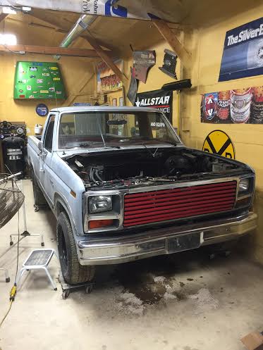

^This is OJ, this truck has been my pride and joy since I was 15 years old. OJ is a 93 with a 351W and E40D trans. I can never leave this truck alone, so I figured I would start building an engine and trans for truck. I am thinking about a 408 stroker and a beefed up C6 to handle the increased horsepower and torque.

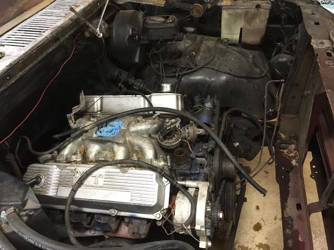

^This is The Deathtrap, this will be my engine and trans donor. Under the hood, that was there previously, is a 357W and C6 trans. The previous owner had the motor machined and rebuilt. It only has 500 miles on it since then, but it did sit for two years.

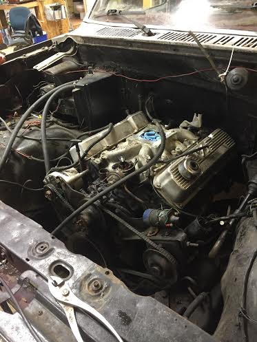

In the last few days I've started to pull the motor out of the deathtrap.
