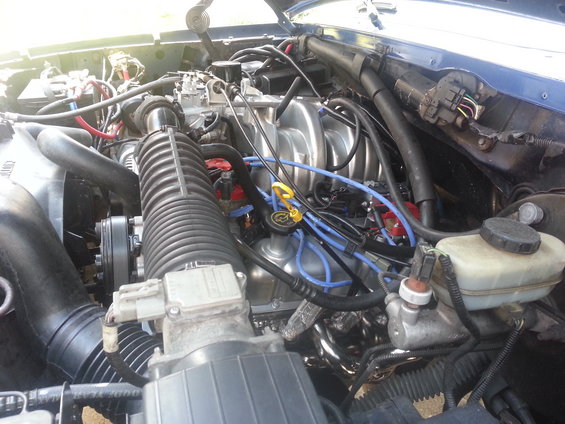

I realize that this thread is old as dirt, but I have a problem with my cruise control. I went on the Ford website and put in my VIN, no active recall came up. Does this mean it was fixed already? Sorry I'm a bit dumb about these things.
Post up a pic of your brake master cylinder so we can see what ya got.
You see the redish colored switch at the end of the master cylinder? I believe the replacement switch is a different color. So if you have the red one, its not been done. At least I think thats the case. If I am wrong, someone let me know.....
The old recall is definitely still active, I got a letter last week for my recently acquired '94, guess the PO, PPO, and maybe the PPPO didn't take care of it.
