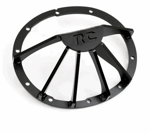

I just dropped the carrier in front to do a D 50 shaft upgrade, got curious about adding some protection to the diff. has anyone seen something like this
Or would a D44 cage like the one pictured fit the TTB as well as the heep rear end?

That TTB is pretty tough already. You'd have to beat on it pretty hard to do any real damage to it! A regular D44 axle needs protection because it's just a sheet-metal cover that's on there from the factory. The TTB is much heavier than that.

The TTB is 1/4" thick, minimum. A popular way of armoring a solid D44 is to cut the cover off of a TTB and bolt it in place.
If I was home I'd take a picture of the TTB that was under my truck that got wrecked. The cover hit a rock that left a pretty good gouge in it, but didn't deform it. Now the arms of the TTB were a WHOLE other story :doh0715:
If you really think you need more, just weld some 1/4" plate right to the housing.
