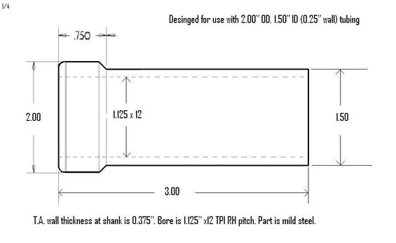

first one... the one most people sell... if i can use a piece of 2" solid that has been sitting in the shop for two years for free ill prolly just make these... if not ill buy them...not worth the cost in steel and machine time... this is for .25 wall tubing

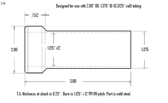

Second one: this is for 5/16 wall tubing which i think they had there..

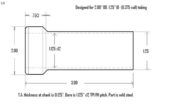

Third: for 3/8" wall tubing(what id like to use if i can find it) the thickness of the threaded bung are is only 1/8".. i think that will be okay though..
