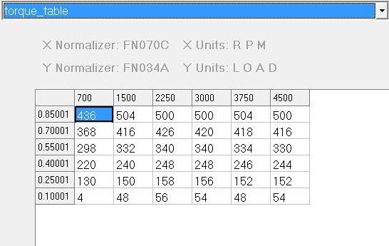

In the second Tweec I changed the Table - torque_table to match the engine output at load. This table has load on the y axis and RPM on the x axis. The number are grossed-up cause I notice the stock numbers were.

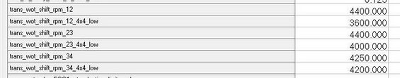

The third Tweec was to increase the RPM for the initiation of WOT shifts.
The cam and blower allows this engine to spin-up faster and too higher RPM. I originally added 500rpm to the wide open shift point Scalers for the stock tranny. The screen shot below is what I ended-up with for the Punisher tranny I installed. This worked, but the shifts were slow and mushy! I needed to do more! It is important to remember that this is the RPM that the shift starts.

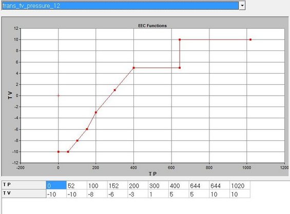

The fourth was to the trans-tv-pressure-xx Function, where xx is 12, 23, & 34. This Function has TP on the y axis and TV on the x axis. I changed the last four cells for 1st to 2nd from 8, 8, 15, & 15 too 18, 20, 25, & 25. Now she has a little snap into 2nd at TP values approximately 2/3rds to WOT! I also brought-up the TV pressure for 2nd to 3rd in the last four TV cells from 2, 2, 5, & 5 too 10, 15, 15, & 15. It seems to me that the Function trans-tv-pressure-xx is an adder as there are negative numbers for the lower throttle positions. The TV value for the shift from 3rd to 4th, at the low TP of 152, is -5, leading me to that conclusion. It is not sucking a -5 TV pressure to shift into 4th so must be decreasing a preset TV pressure amount by 5.
Again this screen shot is of the Punisher tranny tune with more aggressive valve body, The TV pressure numbers are stock cause it already shifts very snappy.
