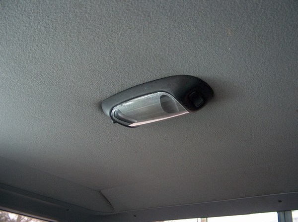

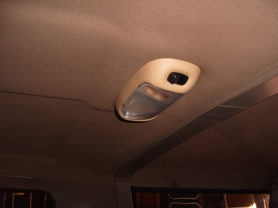

I got tired of the old, ugly, oxidized, pitted, dull illumination, antique, factory Bronco dome light and ditched it last night... Man, that thing is hideous...
I replaced it with a dome light out of a 95 Mustang... which is TONS better and looks awesome once installed!
For those wondering what one looks like, IF you have never seen one, it looks EXACTLY like this one:
http://cgi.ebay.com/ebaymotors/ws/eBayISAPI.dll?ViewItem&rd=1&item=7981266947
It is a DIRECT FIT, DIRECT SWAP, PLUG-N-PLAY, NO MODS NEEDED AT ALL! :rockon
The new dome light has MUCH better lighting qualities, plus the dual map lights are WAY better than the original Bronco map lights... it looks awesome once installed too - gives a slightly more modern look... This unit ROCKS!
EASY Directions for swap/upgrade:
1) remove old dome light lens cover (if yours is still in place, many of them fall off and get lost or broke over the years). To remove it, grasp the lens cover and pull, or, use a small flat head screw driver and pry off the cover. If yours is already missing, you're ahead of the game!
2) Get a Phillips head screwdriver. Looking at the dome light base once the lens cover is removed, there are (3) Phillips head screws. REMOVE all (3). Once the 3rd screw is almost out, grasp the dome light, otherwise it will fall on your head. Remove dome light, stomp on it and throw it away, or resell on eBay for few bucks
3) After old dome light is removed, there *might* be a white plastic triangle spacer still attached to the ceiling OR it may be on the back of the old dome light - you can DISCARD this piece, as it is not needed.
4) Get your "NEW" 94-current Mustang dome light and remove the lens cover. To remove the lens cover, there is a small indentation on the base under the lens cover, use a small flat head screw driver, insert into the indentation area and pry off the lens cover.
5) Hold the new dome light to the ceiling and match up the (3) screw holes (you may need a flashlight or shop light to see through the little holes for alignment).
6) Re-install the (3) screws to secure the new dome light to the ceiling. Test the light out by opening the door, or turning the light knob ON so you have the interior light on with the door closed. if all works out well, re-install the lens cover (it just snaps into place)

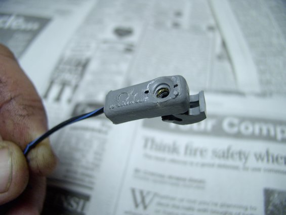

Here is the typical setup. I removed the grey clips that were in the roof in case they are needed. I had a broken one when I plulled mine off. One is hot, one goes to the door switch. The third screw grounds it out.

Here is the other style. It uses the same screws but uses a plug to provide the power. It's still built the same so you can forget the plug and use your clips to power it.

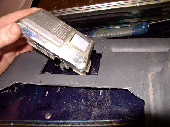

Presently I's-a-workin' on an overhead cargo light, I purloined out of a Windstar, all into an 86

The tips of the power screws have worn thru the paint & are now grounding to the roof. If you had the chrome map dome, the screws DO line up. You might have to cut a plastic peg off the new dome so it fits flat, but it DOES line up with the original screw locations.

steve, what do you meen tips of power screws worn thru paint? I've got the two screws, one for each wire. They screw into that plug, but never contact the roof. The only one I have screwed into the roof is the lower left one, which I believe to be the ground. FYI, i'm using the second light assmbly shown, the type with the plug.

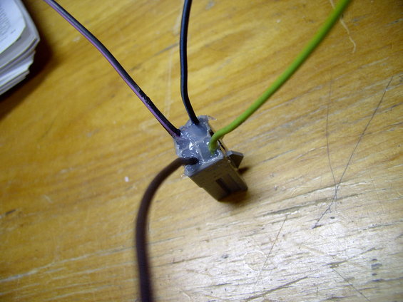

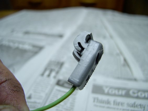

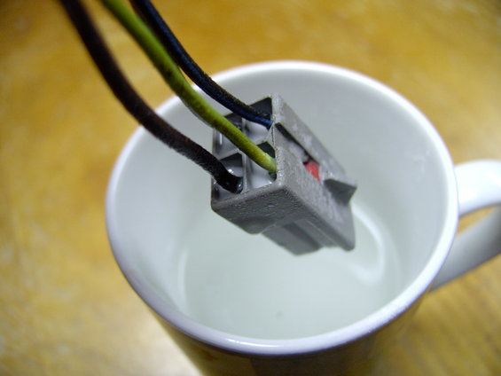

What Steve is talking about is the same thing he saved me on 6 years ago
At the base of the B-pillar, inside that access hole under the seat belt retractor you'll find a snake's head of wires. Chances are real good your lime coloured wire, or more, has corroded through.
That's why your spots don't work no more. The other area that is notorious for corrosion is behind the kick panel, under the E-brake. You're looking for this connector;
Chances are good, it too is corroded out. In the pic a decent one is being dipped into baking soda and warm water to clean up the corrosion before it's sealed here;
Good luck reaching the B-pillar, its a real beach ! When I was painting my Bronco last year I had every wire in the body out, so while that harness was out I took the opportunity to lengthen and properly replace the wires running up there. Several times, since I've owned Eddie, I'd had to get into that tiny hole and shorten and repair the corroded wires.

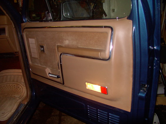

I didn't stop at the upgraded dome, I was so P.O.d at being in the dungeon I added Lincoln door lights, already had under dash lights. Then I added two extra cargo area lights into the now redundant rear seat ashtrays.
Now I'm sticking a Windstar dome light directly over the rear cargo area, with a disconnect-able wiring harness for when the top is off. I'm mounting it far enough back, that when the glass is down I'll be able to reach in and switch on the two map lights if I want some light over the cargo area when my doors are shut.
It's already lit up like a Nevada whore house and I'm going for more !

that bottom connector you show on mine, for the power is broken apart, exposing the inner metal part. However, I could still screw it on, then electrical tape it to prevent shorting out against the roof.
before I started this venture, the dome and side lights worked perfectly. this is what makes me suspect my install.
