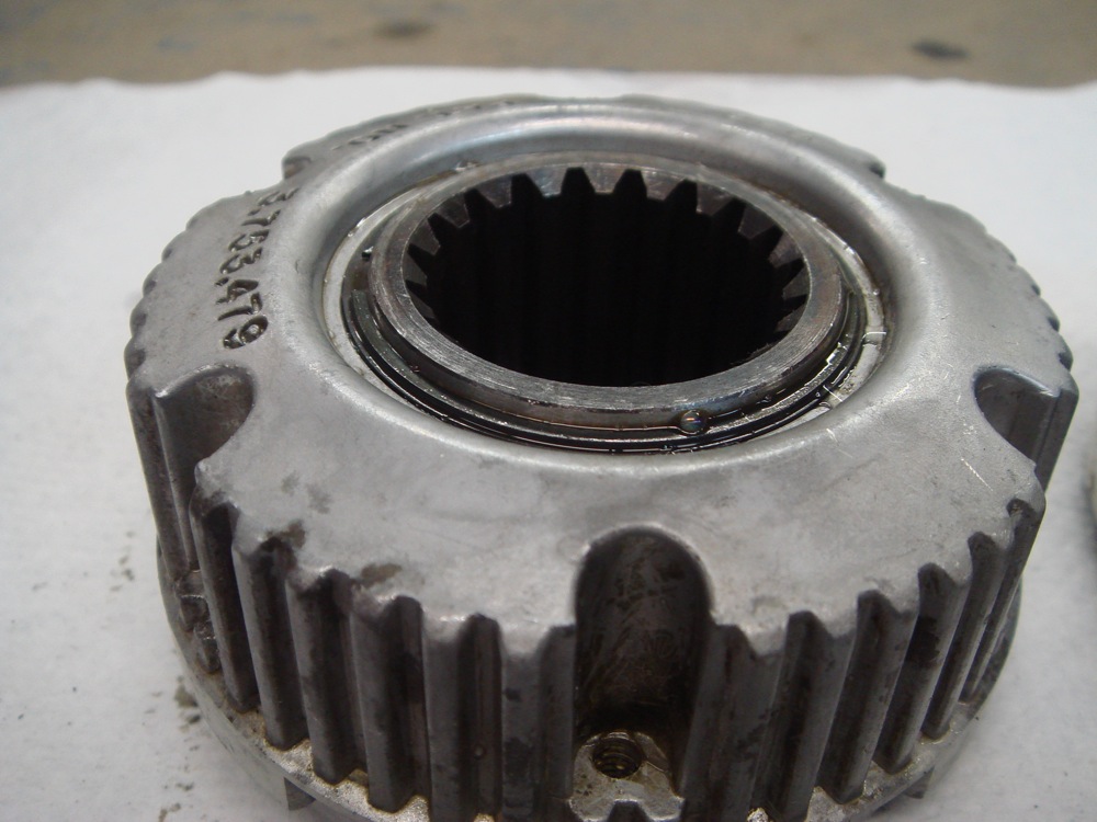

I couldn't find an exploded view of a warn hub so I took one a part in reverse order of assembly for reference.
Left to Right
Snap Ring, Plastic Bushing, Clutch Housing, Shim, Axles Shaft Hub, Spring, Outer Clutch, Screw.
Bushing installed
This is the direction the Outer Clutch installs, install it the other way and your hub will not engage. (I found out the hard way)
Screw holds it together.
Left to right
snap ring, plastic bushing, clutch housing, shim, axles saft hub, spring, outer clutch, screw.
bushing installed
This is the way outer clutch goes in, install it upsidedown and your hubs will not engage.
Screw holds it to geather.

Thanks for posting this. I'll be doing the hub swap soon.
