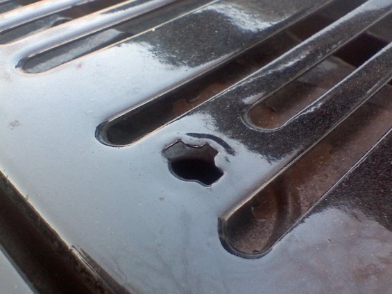

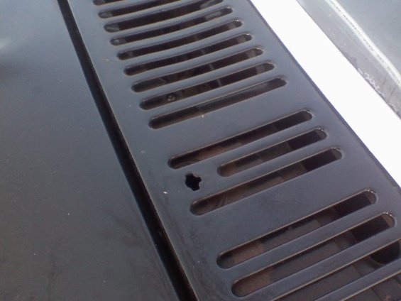

This is the hole where the washer sprayer nozzle should be located but i'm not sure if it is there. I have an '81. Is the nozzle far down there or would it be sticking out. I took a look down in there but it was too dark to see anything.
69 Posts
so all I need to get is a nozzle? DOes the nozzle connect right to the hose and how does it mount in that hole??
Kitteh Commandaar!
4,191 Posts
It kinda "snaps" in place. Little clips hold it down in, then you push the hose on to it...
And yes..yes it is gone. :cry
KC :beer

okay I got the nozzle but how does the cowl come off?
There are about 6-8 phillips screws across the front on the firewall and a couple up top looking down between the wiper arms.
Take the screws off and carefully pull it out from under the windshield molding.
It is difficult to get it off (without scratching it all up) without taking the hood off but it can be done. I personally would take the hood off. It makes it a lot easier to remove.
