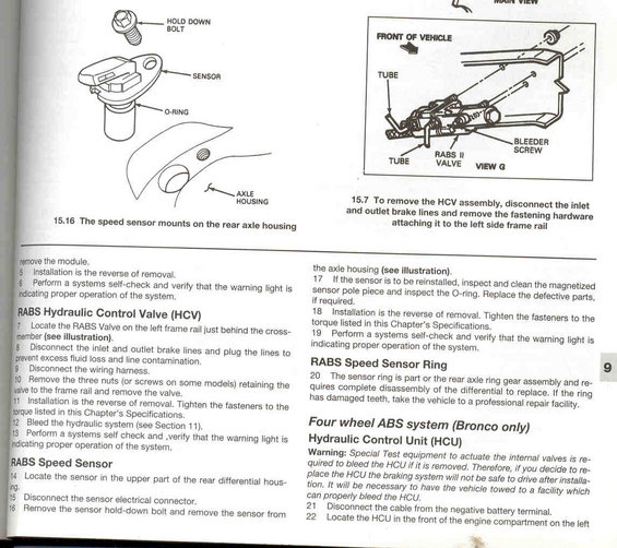

You don't have to rip apart your rear end to check the sensor, it is located on top of the pumpkin.
Thanks for the pic, but I really do need to tear into the rear diff. I posted earlier that the previous owner ran it low on fluid amd it's just a howlin'! I bought a new install kit and an Auburn limited slip to install this week. Hopefully the ring and pinion is fine.
