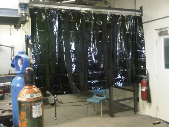

Fixing up the High School Welding area, I made a track today for a welding screen.
Some would do it this way with threaded rod
I took a different approach - cause I have to be different (Some say difficult)
SO I take a 10foot 2x2 and slice a 5/16 cut down one side of it on the Mill
Test fit the track
Weld 3' of 2" DOM to one end.
Finished. One end mounts to the wall, the 3 feet of DOM is bolted to a beam.

Why DOM? That just seems like a waste. Standard HREW would have been more than sufficient and less than half the cost......But you already know that. LOL
I want a mill like that!!! Screen looks good
Why? It was scrap left over from my cage build, and it was right there. :beer

How much if any did the 5/16 cut close in the 2x2?
2,629 Posts
What is the shield made of. I wanna make a little one because I usually weld in the driveway and dont need other people seeing my flash.
