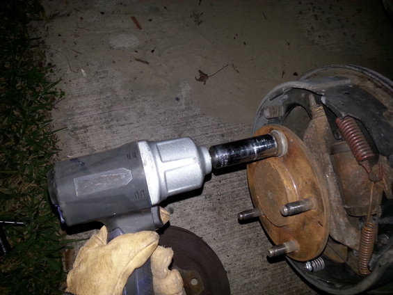

next I got a stack of thick washers and an open ended lug nut, the idea is to use the washers to draw the stud into the shaft..
I cranked down on it with my impact..its a cheap HF model, but it got the job done..you could also use a breaker bar if you don't have an impact.
and there it is, the new stud is in place, ready to put the drum back on..
