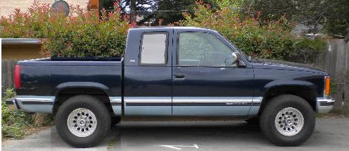

i've got a old truck thats not really a good tow rig but great at everything else. trouble is i don't really need an 8' bed. i don't even really need a 6' bed. but its slow in the dirt cause its long, short wheelbase trucks do have their advantages. its one of those "almost free" projects that would just make the truck so much more fun to drive. but the truck is all original and been in the family since i was 5. discuss.

Don't forget the shorten the fuel lines, driveshaft, emergency brake cables, exhaust, and I'm sure I'm forgetting something else. Is the tank extra long or is it a center tank, will anything hit it if you shorten the bed?

Your goona have to pull the tank, shorten drive shaft , move filler door modify the bed/cab for the up swing on the frame rails. Personal I would bring this to the GMT400 forum. I know I may get banned for posting a GM forum on here but it is to help this guy out.
Its a good thing you mentioned that because I'm sure he would have forgotten to do it. Even after he would go to put the driveshaft back in and found out its 3 feet too long.

jeez guys, its not like a family idol or anything. i just have a lot of good memories of how well it works. but now times change and i think it might work better if it were shorter. its just the slippery slope principle, right now its a clean, un cut everything except the wiper switch works just fine truck. hard to tear into and cut up something that already does its job just fine. i'm afraid of what it would turn into, i don't need another project. i just need something that reliably drives around town, can go to the snow or sand, and can hold 7 or 8 sweaty gnarly mountain bikers at a time.
but it would be unique....
food for thought, a 40 gallon suburban tank would take the place of the spare tire very easily and keep me smog legal. e brake cables could be sourced from a reg cab long bed since thats the end wheelbase i'm shooting for.
