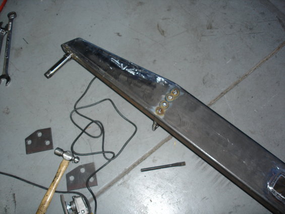

This is the rear bumper I have been working on. I finally got around to cutting and drilling the brackets. I also cut the bottom portion or the rear sheet metal on the quarter panels. I got the main idea from the big mike bumper. Except I used 2x6 and instead of radiusing the ends I did straight cut's cause I don't have a plasma. :twak
I still need to build the tire carrier but I will update this thread as I do more work.

Well I got the piece of 2x6 for free from my step dad. The plate I got from curtis steel in the crap bins I think around $15. The rock stomper pivot hinge was $40ish I believe.
I just picked up some 2x3 1/8" tube yesterday to make the tire carrier. They didn't have any scrap so I had to buy a whole stick which was $60.
I got a good start on the tire carrier yesterday I will get some pics up soon.
