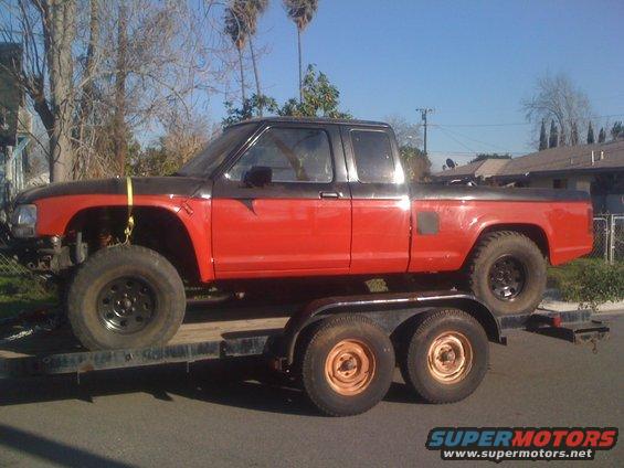

Bringing it home. :thumbup

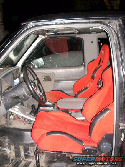

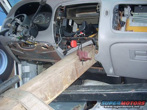

the interior is was gutted minus sparco seats, a dash, and a little center console. this is after i started tearing into it.

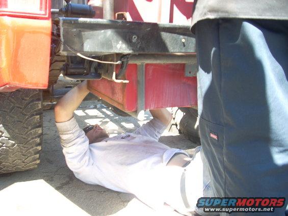

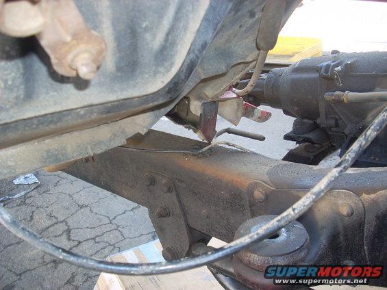

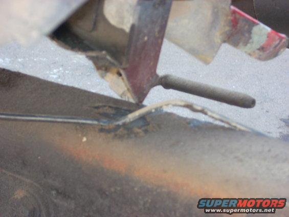

despite what the PO says the truck was layed on its side at one time and broke the bedside mount and he "attempted" to weld it back on. one little wiggle and it broke off and left this.

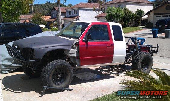

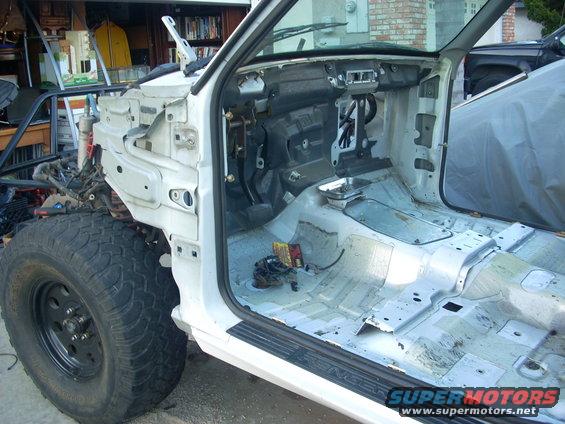

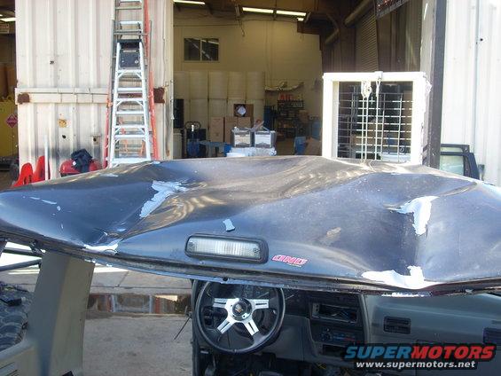

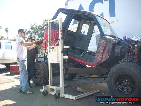

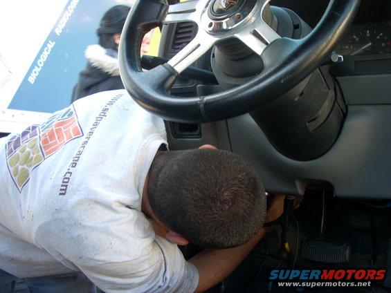

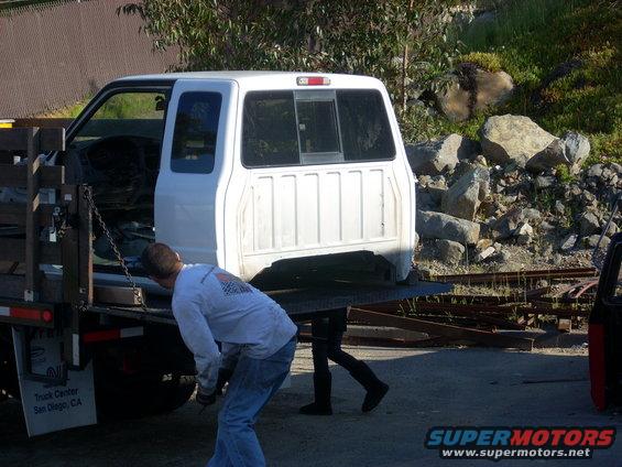

after doing all this work to the ranger i tried to register it and found out the back reg is $938!!!!! i said hell no!! so killing 2 birds with one stone, i decided a cab swap will fix my reg. problem and give me a non-damaged cab. yesterday the cab swap took place thanks to the help from Marc (worldclasssniper), Vic (Spectre), and my GF. pics of yesterdays activities will be posted shortly (currently uploading)
