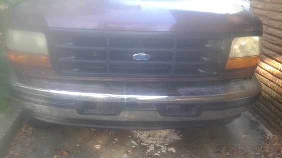

front bumper is damaged, needs to be replaced

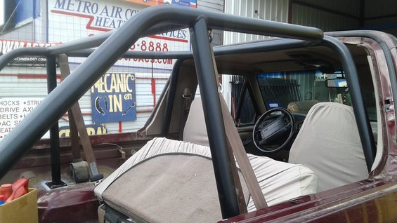

i don't have a lot of pics but i'll post what i have. i took the bronco to three different locally respected 4x4 shops to look at that roll cage. i told them my goals for the truck and asked if i should have them tie it to the frame. the consensus was this: they could do it, but it was unnecessary. the cage was well built and would be sufficient for a basic rollover.

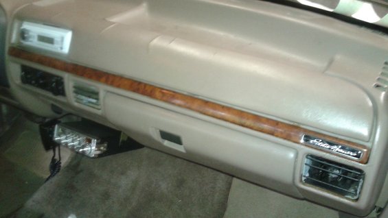

*pulled radio & door speakers, replaced with marine radio & speakers with fresh speaker wires. back speakers are waiting to be installed.

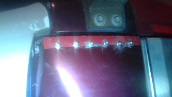

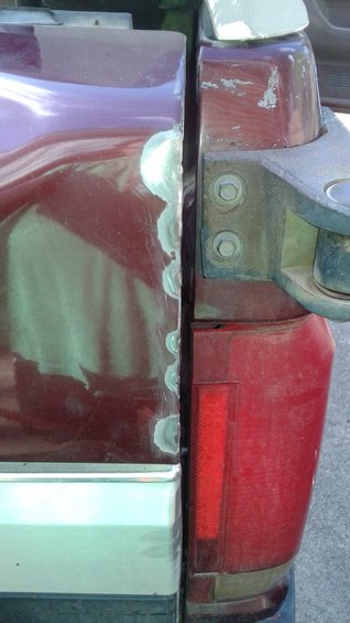

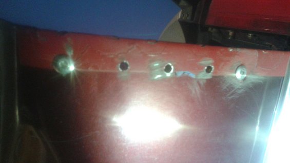

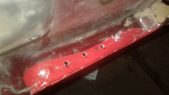

*back window leaked. discovered the tailgate skin was sheered on the passenger side. when the spare tire was not attached to the tailgate, the window sealed. when i closed the tire swing, the weight pulled on the skin and it pulled the seal away from the window. i got the skin welded (no, i can't weld) for $20 and now it seals. we'll see how long that lasts
this was my first attempt to fix the leaky rear window
here it is welded back together. i need to do some clean up, but for now at least the window shouldn't leak. and that was job 1. you can also see the leads for the rear window motor coming out of the back, too.

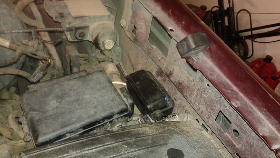

*investigated the airbag light. it's flashing code 21, which is a sensor not attached properly. i looked and found the sensor was not attached at all. the guy who built the roll cage removed it to run the cage there. i have to sort out what i'm going to do with that later
