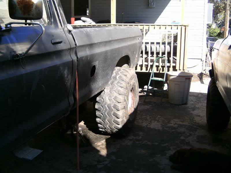

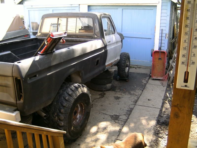

OK here is the truck I'm starting with for the BOGGER
its a 76 F250 4x4 Hi-Boy I used for parts on my 78 Bronco, plenty of room in the front of that bed to centralize the weight
it has a great strong running 390 already in it

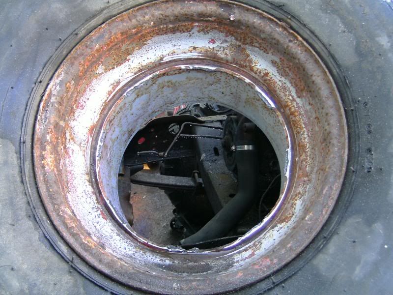

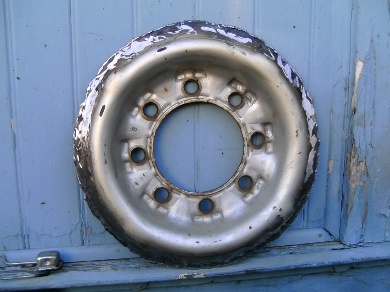

I have already started doing the rims like you were saying Streetcar (brilliant minds think alike??)

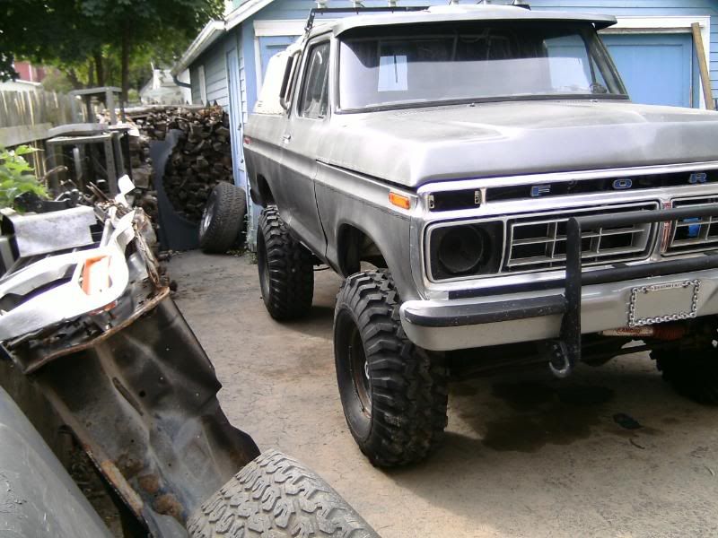

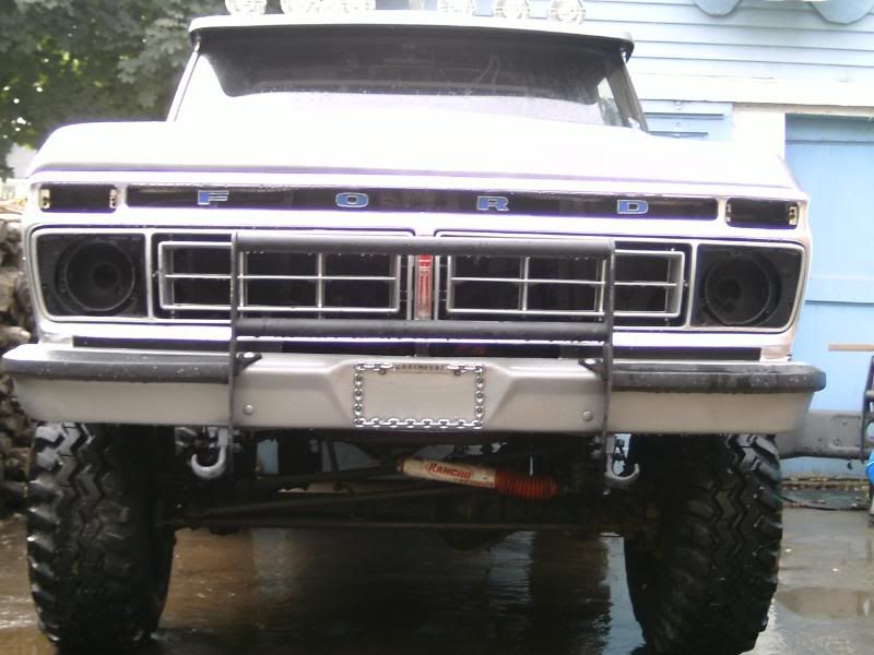

here's my Bronco, I call him " BEAR METAL "
