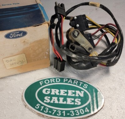

Since no one makes them, has anyone found another 3 wire push button switch that might match in order to use the mecanism and just replace the switches, I know that EATON made the but from what I see in their webpage they dont seem to have anytthing similar available

I think this is the same as the ones used in our Broncos (not the harness) and it can be adapted just splicing the wires to the Bronco harness. The key cylinder fits perfect (I tested with mine) unless this is a different version but it looks the same as the one I purchased as a spare switch.
