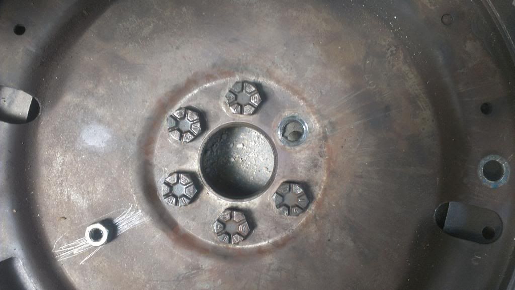

^^Haha funny^^ :p I'm not giving up, here's a pic of the aod starter gear on top of my zf5 flywheel, this is the closest it comes, no matter how many times I spin it, but you can see how far off that one bolt hole is.. what I was asking is if I only use 5 bolts is that safe? Will I run into a balance issue at high rpms?

so i just talked to my friends over at oriellys, they pulled a brand new flywheel out, its the exact same as the one i have, as in the bolt holes still dont match up, we also pulled out a flywheel from a bronco with the 302 and mazda 5 speed, it looks to be the exact same as f250/351 flywheel, 164 tooth, and the bolt holes still dont match up with mine, they did match up with the f250 bolt holes.. hmm i guess if i get them torqued down tight enough i could live with 5 bolts.. makes me weary though..

There is an imbalance built into the flywheel. You can see the weight welded to the backside of the flywheel. If its in the wrong spot your engine will nuke. Put a paint strip across the crank and one of the bolt holes. If it does not line up move it one hole. Keep doing so untill all six line up. If it drops you know ok i was @ three holes to the left when it fell and you can begin from that spot. They will all line up they have too there are only six posible locations. Keep trying.

i figured it out!! man thank you guys for not flaming on me, im sure some of you had your hands on your heads shaking in disapproval, how can some one like me be attempting this swap if i cant even line up 6 bolts..
what i did was line up the flex plate, see where the weight was on it, and then lined up the flywheel with the weight on the same spot and viola!
and i figured out what i was doing wrong, i gave up to soon trying to fit it on the crankshaft because it was dark and i got bit by two spiders(which looks pretty gross today lol) and i was in an awkward position trying to hold that heavy flywheel with one arm, i must have missed the wrong spot when i kept dropping it and lost track, so i gave up and tried matching it to the flex plate because i could line those up alot easier.. Well they never lined up because i had them both on there backsides!! (because the backsides protrude a little bit, so they could lie flush on each other) so they were never going to line up because i had one backwards!! Ill tell you what, it felt hopeless for a little bit, now i just feel like a moron, hopefully someone can learn from my mistake, thanks for the help and patience everyone :) i should have this done by tonight now
