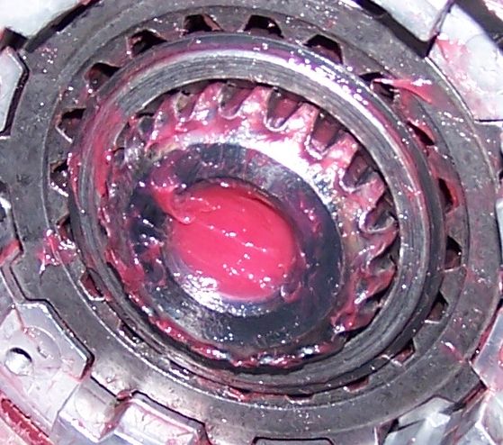

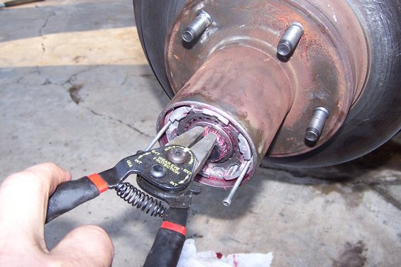

New issue, these new Warn premium lock outs are thicker. All that is left to do is put these new lock outs on, but the first piece that goes on is thicker than the Super Winch ones I am replacing. They do slide in, just not far enough to put that big C clip on that presses outward against the inside of the hub before you bolt the caps with tha actuating levers on. The Warn lock outs come with a C shaped snap ring that you need snap ring pliars for, but I have no idea if I use it, or where it would go. Its seems as if I need hubs that are longer than the new stock style ones I just bought. Anyone have any idea what is going on here? @miesk5

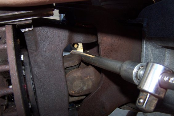

Yo offduty,
As member Iolaus wrote @ 1990 ball joint replacement
"I ran into a problem at this point; the groove for the snap ring wasn't accessible.
I tried pushing the lock further in, but it was fully seated. I pulled the lock and tried pulling out on the axle, but it didn't budge. I finally went to the back side and pried on the u-joint to push the axle further out. That finally did the job!
So then I was able to install the snap ring.

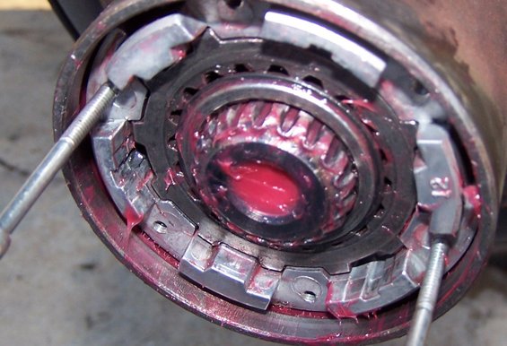

Thanks @miesk5, i will give that a try. Hope I can get some movement in it because I need ablout 1/4“ - 3/8” more. I cant see how that will solve my issue in my head though. The axle shaft is already flush with the end if the hub. I removed the top 2 pieces in the picture and managed to get everything else together. I am fairly uncomfortable that is not safe though. Is the clip in the center the axle retaining ring? Also I dont think there is a groove for that snap ring on the bottom on the end of my axle. I did not have one to remove to get the stock Super Winch ones off

Think I may have this figured out. If the top 2 components, the washer with splined inside and the C clip are not used the hub lucks will fit. This allows enough depth inside the hub for the deeper Warn premium locks. The snap ring in the bottom of the pic would then be able to be used after the deeper lock out was installed. I was wrong, I do have the groove on the end of the axle for that snap ring, just did not have a snap ring on it origonally. Does anyone know if the snap ring actually replaces the splined washer and C clip as the axle retaining ring? I plan on calling Warn monday to ask them .

#18 ·
