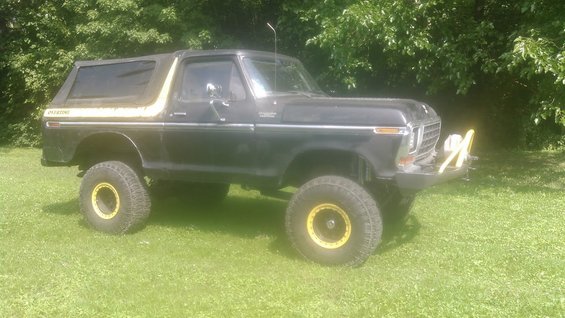

Also just a pic from the other night at full droop

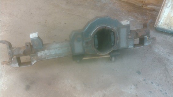

Re-indexed and welded on new perches over this weekend. Set the pinion angle and such. Much happier with no wedge. Drove it a bit without the traction bar and the ruffstuff perches help out a bunch with wheel hop. Bar is back on now though
Like I mention I ended up 1/2" rake, or the rear is 1/2" high now. :thumbup
Lot better then 2" lower.

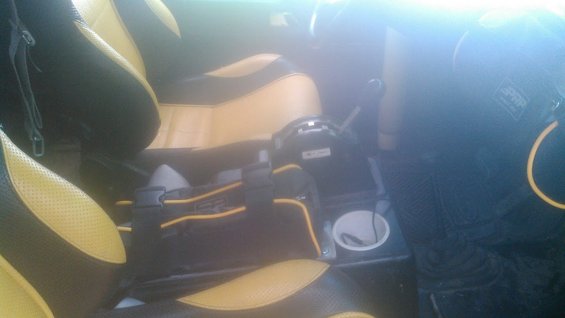

Then I made an aluminum plate to mount this PRP bag to my console. Should work great. The bag has straps the secure it down, so you can un click them and take the whole thing with you. For example when I take the top n doors off.

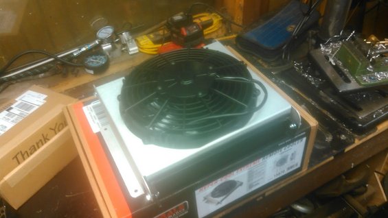

Got my trans cooler installed. Its a tight fit. Just for a size reference the fan is 10"
Fits in here really well though, considering how big it is.
Also made a new sticker.
Need a couple of fittings to go from hard line to the braided #8's. Then just need to hook up the electrical stuff for the fan and should be good to go :thumbup

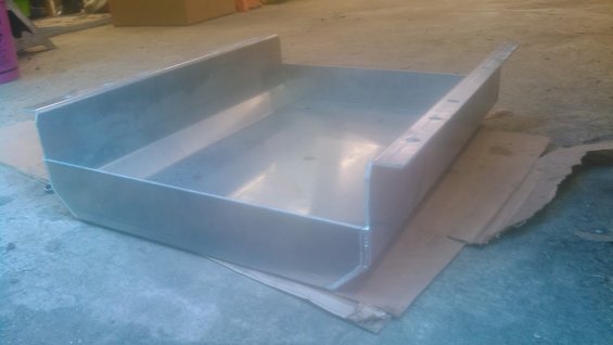

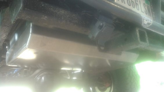

Desolate skid plate came in today. Its nice. I also got the sending unit I needed

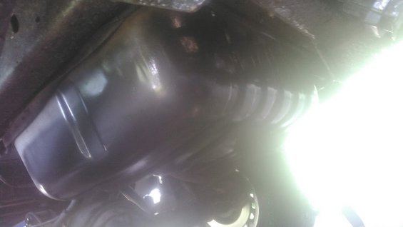

Couple ratchet straps along the tank seam to hold it up while taking the skid off, I also cleaned it up and painted it. I see a new tank in my future.
Install was as easy as the stock skid, very nice fit. Had to clearance it some on the front for my brake line. Also trimmed the passenger side to clear the exhaust, most will not have that issue but the 4" tail pipe on mine requires some extra effort. Even trimmed a bit its still a lot stiffer then the stock skid.
Re-installed the front valance and took it for a road trip. Trans temps are much better now, and a none issue now, That Derale cooler works great.

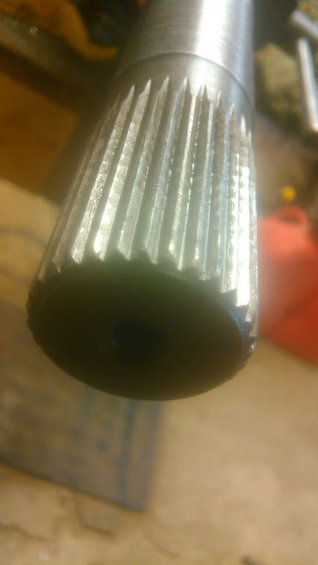

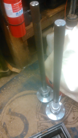

Pulled one of the rear shafts yesterday to verify some measurements.
The splines look surprisingly good considering that they have been in a spool for 4 or 5 years. These are Yukon shafts, I am fairly pleased with them.

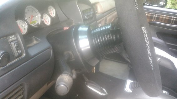

These grant parts made this pretty simple.
To get to this point, I just used a puller. Yes the stock bolt holes stripped out. Luckily I was able to drill and re-tap them to something bigger. Easy enough. Though one side did end up breaking, it did come off too.
With the billet adapter all you gotta do is take the piece off the bottom of the stock wheel and install it on the grant adapter. Electrical connection for horn plugs right in, just like stock.
it also covers up the column nicely I thought.
The final product. I like it

So I did find an issue on my Grant wheel install. The base of the billet adapter is not machined fully to sit flush. What happens is the horn wiring connector will make the wheel tip up at the top. I had to remove my wheel again to correct this. I simply machined out the extra material and works great now. I originally removed it again because the trim ring was hitting the plastic shroud on the column making annoying noises. I also trimmed that up a bit. So with that fix it works like it should now. While you should not have to do these things, I think id still buy the kit again its 95% right and that's decently good. LOL.... Now I get to pull it off again as I got it 1 tooth off so the wheel is not straight.
I also took the stupid grant sticker off the horn button, looks much better all black. It would have fallen off soon enough anyways so not gonna miss it.
