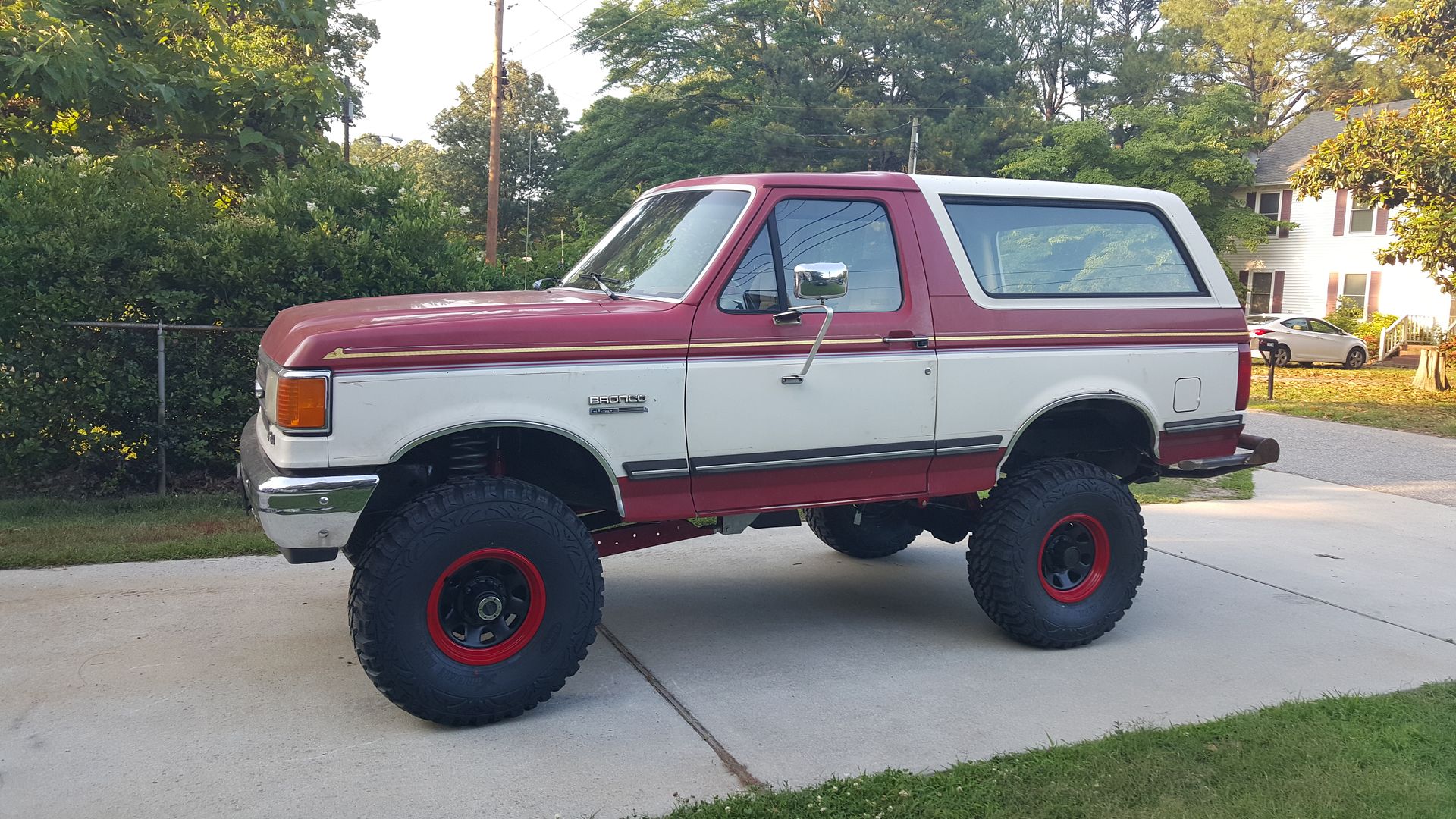

OK here is my question, I am planning on 6" of suspension lift. From what I have read the 91 Brick nose has smaller wheel wells. In the lift section it says I can do a 35 with trimming ( tight squeeze ). Now I am doing a SAS swap with coil over and 14" shocks for lots of droop and extended radius arms. I have a really nice set of quarters and fenders and do not want to put a sawzall to them. So do I need to reconsider tire size and go 33" so I do not eat my nice newly painted sheet metal? I had 33s on it when I got it with no lift but they were like inches away from making lunch out of my fenders and bumper. What's you guys experience on it, 6" sounds like a lot to me for 35" tires are they gonna be ok ?

Rear wheel wells should be the same as 92-96. 80-86 has the smaller square wells. My avatar pic is a 94 with 6" lift and 37-12.50 tires. The front bumper was trimmed about an inch. I jumped this setup many times in my dumber days up to 80 mph and a max of probably 6 foot altitude with a skyjacker kit without a problem.
I have 37's on my current Bronco with 4" of lift and have plenty of room in the wheel wells but I have cut out fender flares so the fender isn't a concern.
