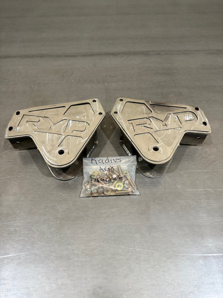

i could buy some aftermarket brackets for SD axle swaps in out trucks. but these are expensive. and only one actually deals with the issue of the 'pinching in' by angling them. these Sky brackets are $400
even the RYD brackets dont seem to deal with that but cost $450

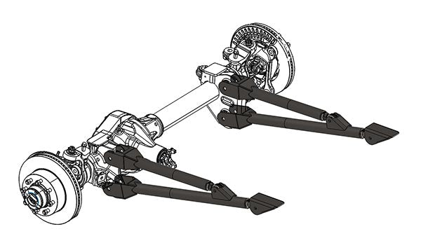

i think its finally time for me to go to new arms. and im pretty sure the Ruffstuff kit is what im going with. also debating the RYD short arm kit but it is quite abit more expensive and complicated, and says for 0-4" lift
i imagine the RYD kit is stronger using 2 arms per side, possibly less alignment change thoughout the suspensions travel, looks cooler. but i imagine it flexes less, its also kinda bulky
the FarFromStock kit looks exactly like the Ruffstuff kit. they even have Ruffstuff hashtags. but they do list using 0.211" tubing instead of 0.25".

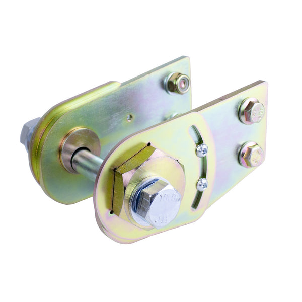

my idea of doing new mounting holes on the arms at the axle are not a new idea. ive seen kits that will do an eccentric on either top or bottom mount. they just seem way overcomplicated for a pretty simple idea. slot the bolt hole, weld a couple bars for the eccentric to center between, add an eccentric bolt/washer. should not really be that hard. but there might not be enough room on the front of the tab to weld a bar for the eccentric to go against. i feel like im going to need ALOT of caster so i need to move the hole alot
but even so, if i can do it right the first time, i would have no issue skipping the ecentric and jsut drilling a new hole. might need to weld a washer or nut if the hole is too close to the original hole.
this kit is about 300$ but only alows for about 3* of caster. it does it a the top mount at the axle
then there is this other kit that extends the lower hole. this looks more fragile of a kit but can do 6* of caster
