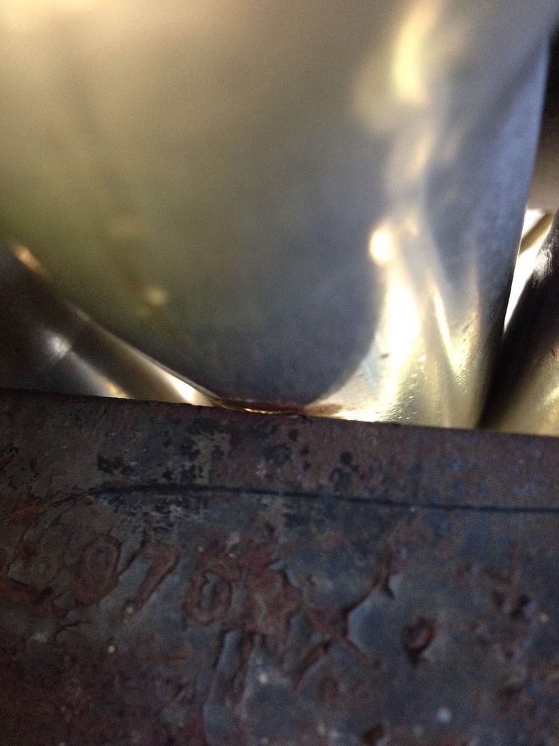

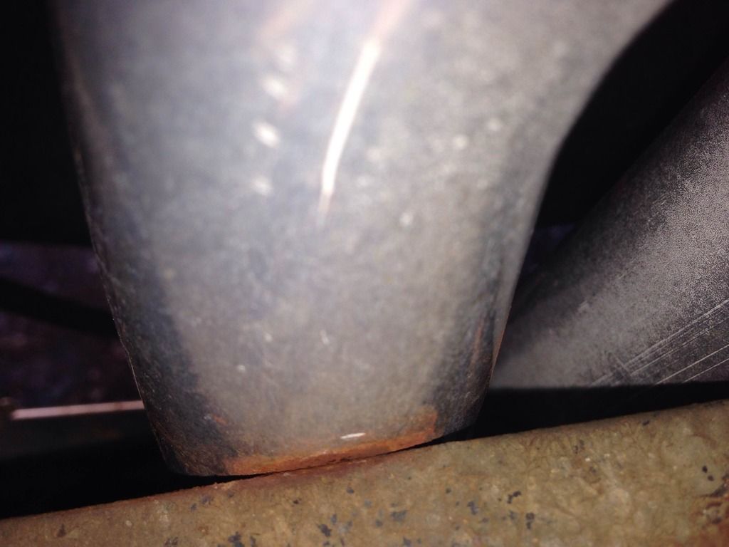

#55 ·
Fighting with these headers I installed. Had a clearance issue pop up on the pass side and a possibly a boiling fuel issue on the driverside.
There is about an 1.5" clearance there between fuel line a header tube. The fuel filter would be a 1/8-1/4 full when hot. I had some adhesive backed heat shielding so I wrapped the fuel line. We will soon see how this does.

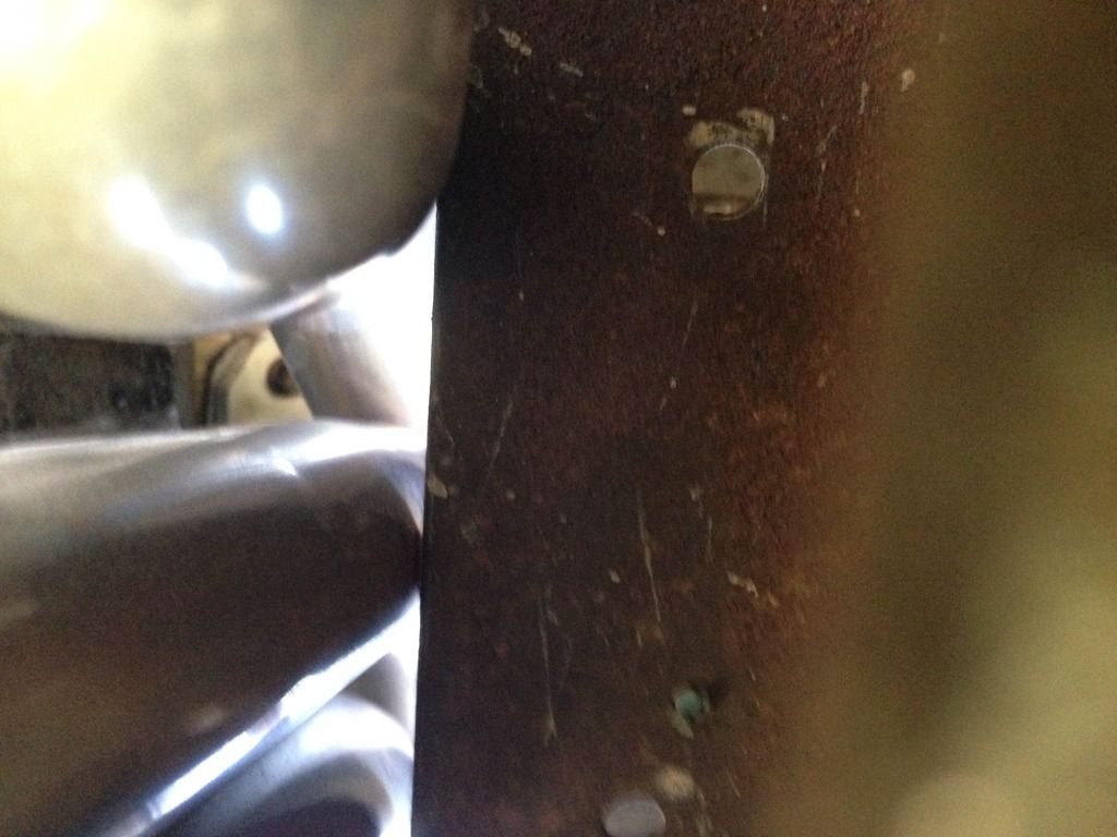

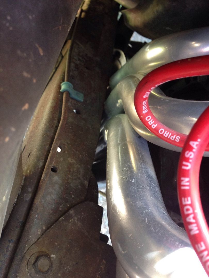

As for the pass side clearance here is what I have.
#59 ·
Yes Mark they are for this Bronco, We followed the instructions and felt it was a tight fit on that side. I'm going to give their tech line a call and see what they recommend. A 1/4" ain't much but it's still cutting the frame and there certainly ain't a lot of room to get in there and do that.
