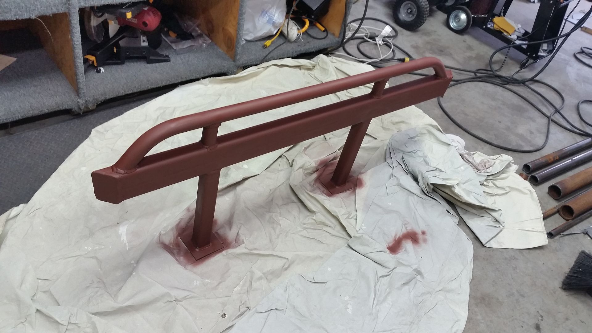

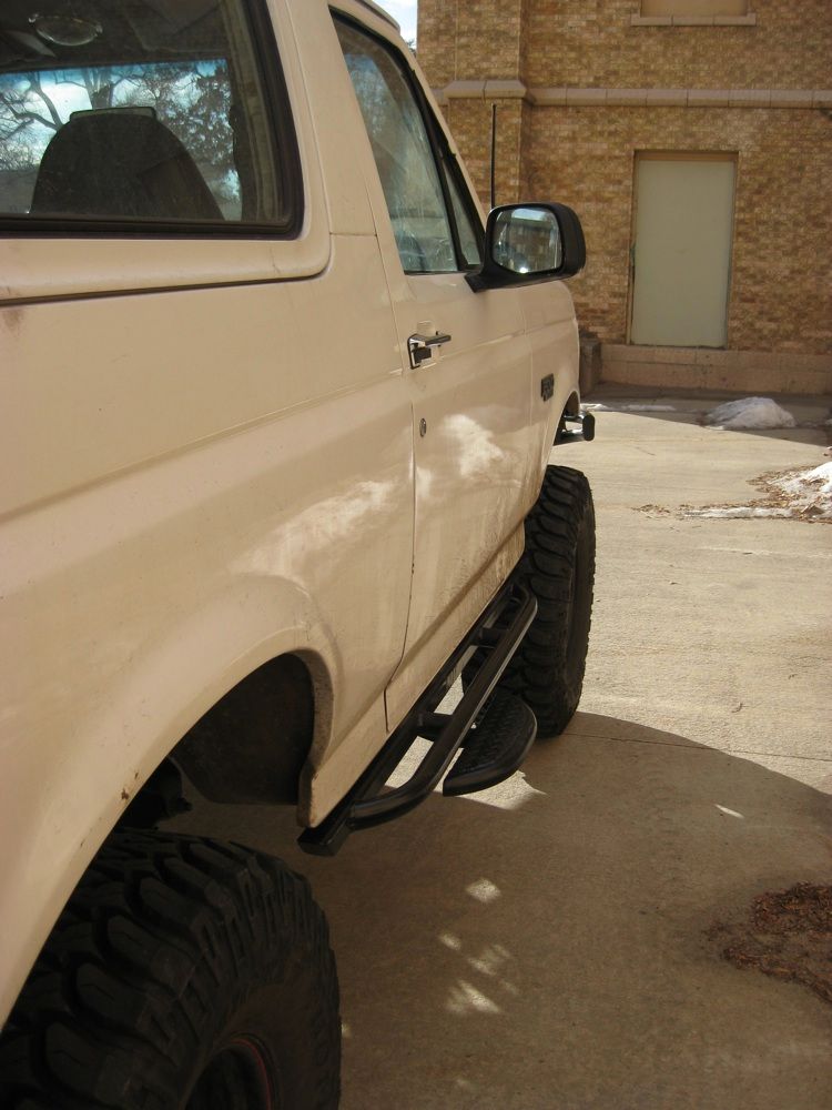

I built mine using 1.75 dom tubing, 2x3 rectangular, 1.5 square tubing and 3x16 plate. I secured them with 1/2" grade 8 bolts,washers & locking washers. I doubled up the 1.5 square tube for the supports. When it was time for paint I scuffed them up with sandpaper and a brillo pad, cleaned them with a duplicolor prep wipe, primered with rustoleum rust killer primer, painted them with duplicolor truck bedcoating in a spray can and rolled on the coating in the "step" area for traction. Finally for the completion I sprayed 3 coats of duplicolor textured metal flake paint.

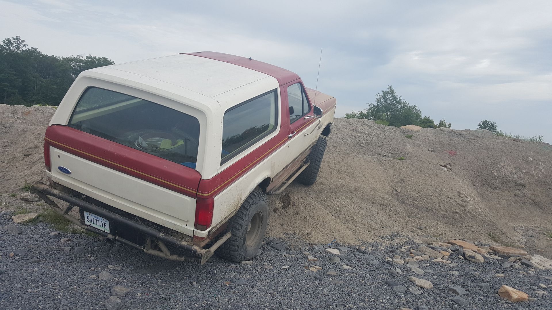

The rock sliders saved getting more body damage on the large rock. The bottom of the rear fender wasn't so lucky when we came off the rock.

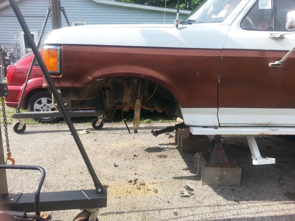

Forgot to post mine. I put them on the Bronco about 3yrs ago. I constructed them out of 2x4x1/4" steel tube they are welded and sealed and could be used as storage tanks (primarily air) I tested them to 140 psi, but never charged them on the Bronco. I incorporated a removable step on each side. I have usex them many times and even jacked the up Bronco with them.

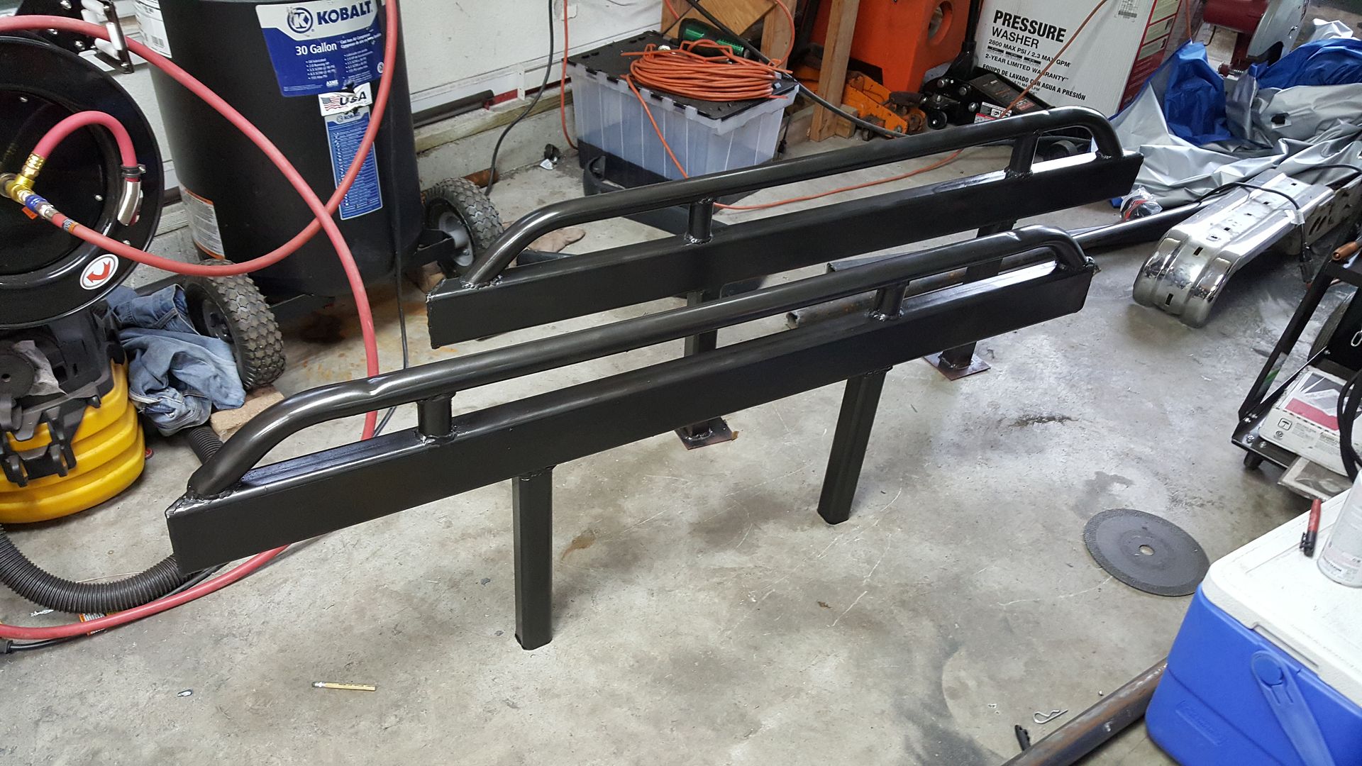

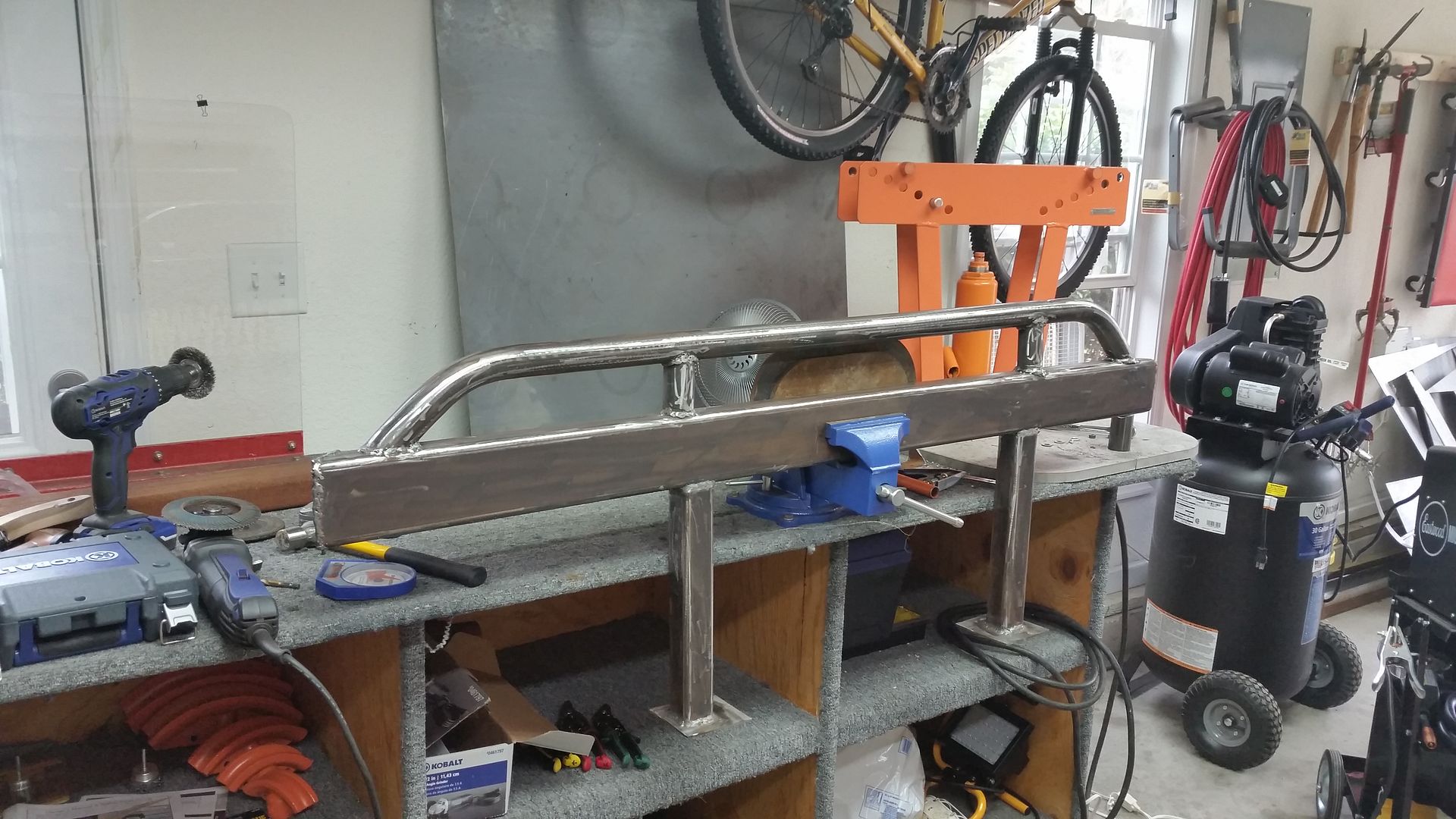

Figure I'll add a couple of the new sliders I made, they have worked well so far!
The main slider is 2x2 .25 wall and the outboard slider is 1.5x1.5 .25 wall.
These things are beef! Really happy with the form and function.

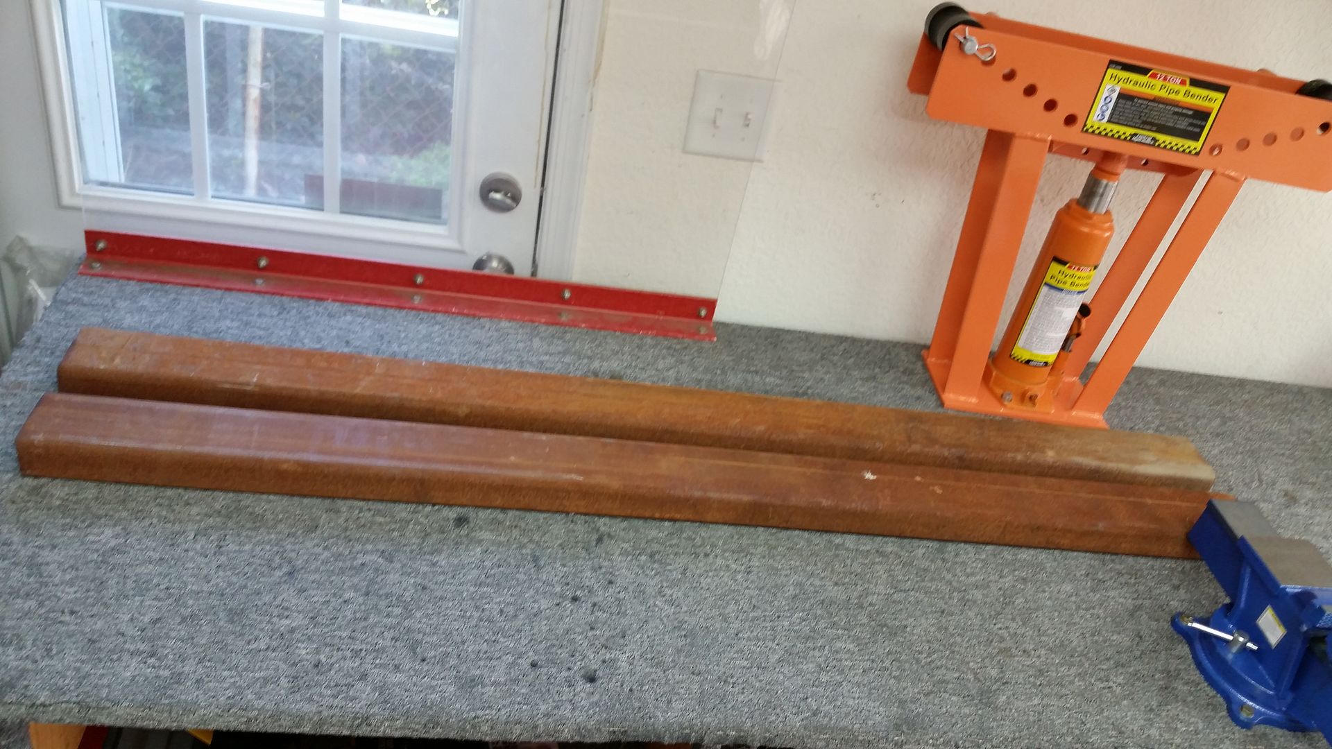

Going to start a set in a week or so.
Greg at a local Fab shop "Rock & Road Performance" is going to put a kit together for me
so all I have to do is fit the plates to the frame and weld everything together.
Will be made out of 2" DOM

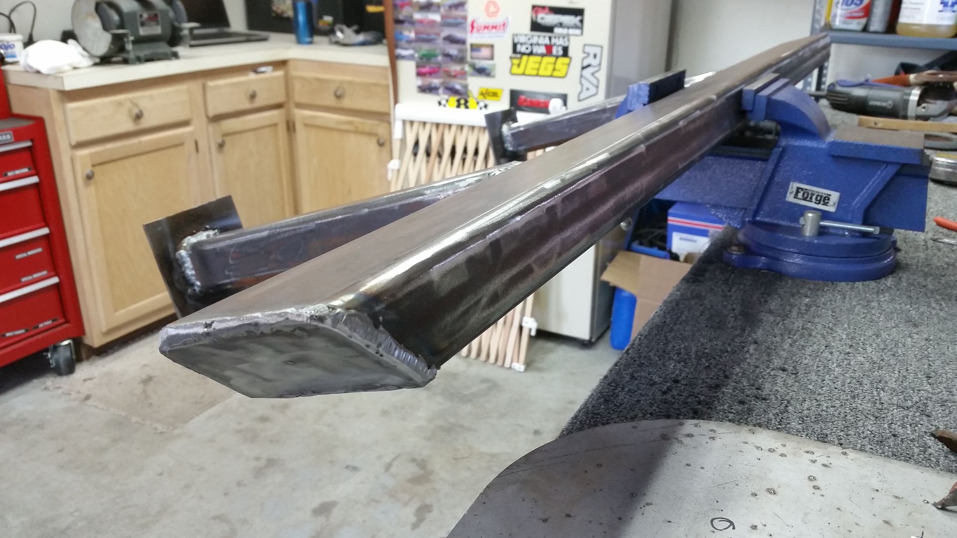

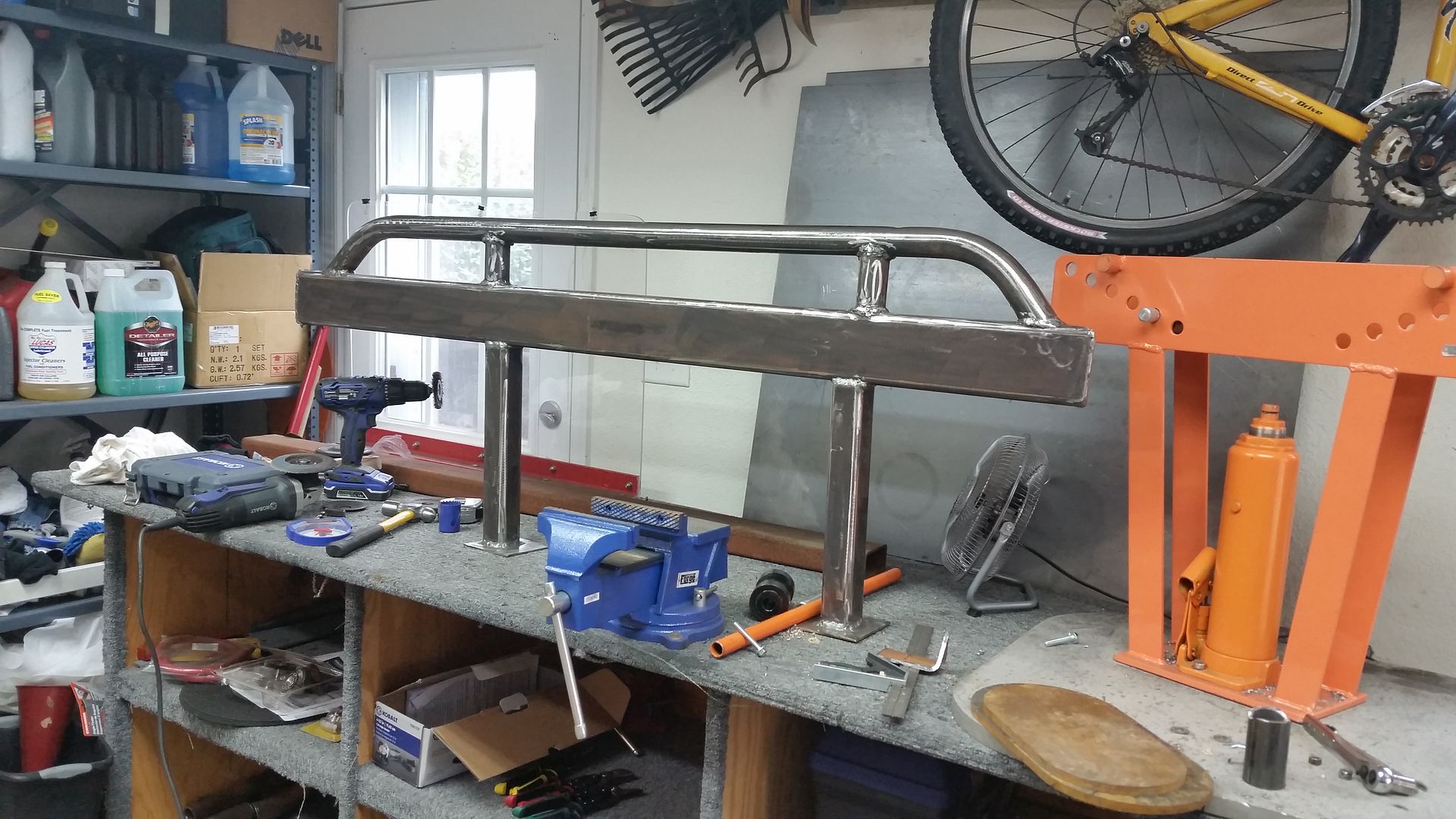

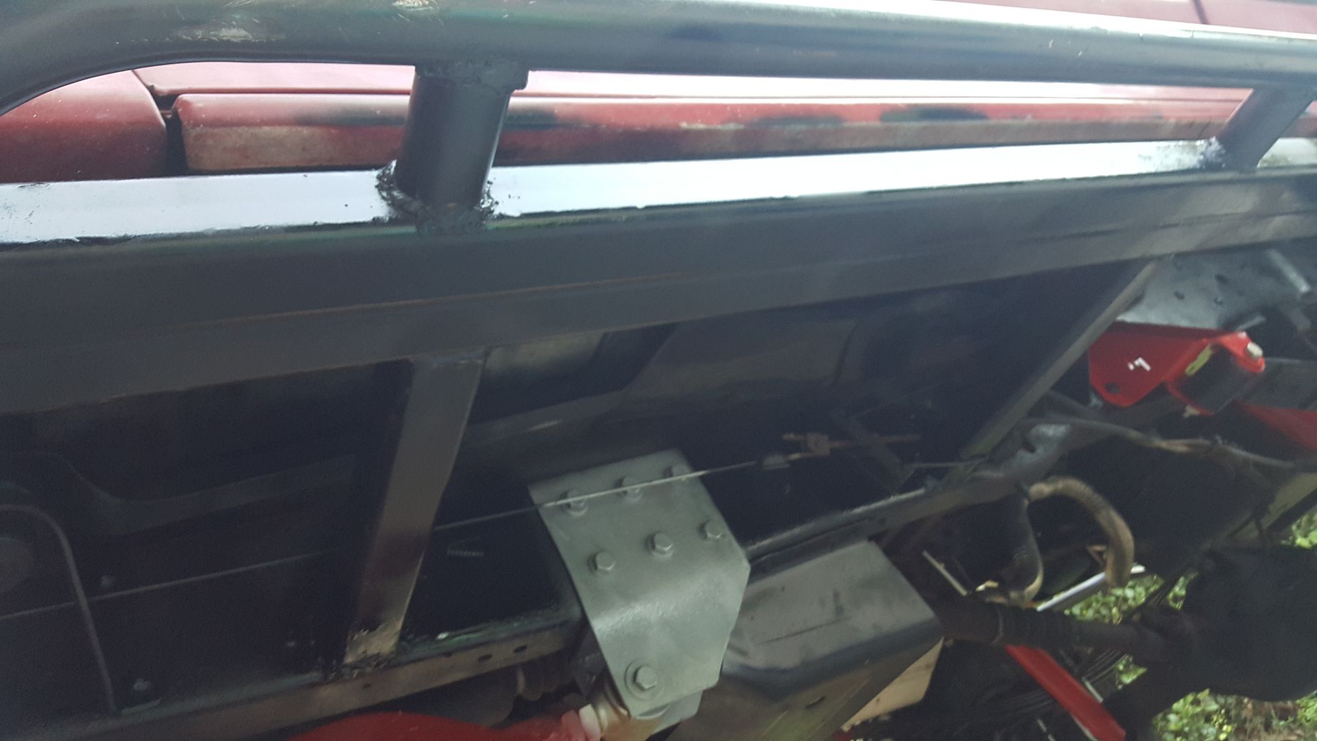

I know it's been a few years, but this has been a helpful thread. I basically copied Saltlife but without the round kick-out. Specs are .188 2x4 for the main, .188 2x2 for the legs, .250 for the plates, rattle-can bedliner and bolted to the frame with 3/8" grade 8 fine thread hardware. Don't judge my poor welds. I also notched to clear the fender mount tab.
On the drivers' side, did you guys have to relocate the fuel filter? The FF bracket is right where I want to mount the plate. Also, any pics of how to negotiate the parking brake cable on the drivers' side? I'm thinking of mounting the drivers' side right where the cable goes to the split bracket, but I'll have to remove the spring and cut that tension screw.

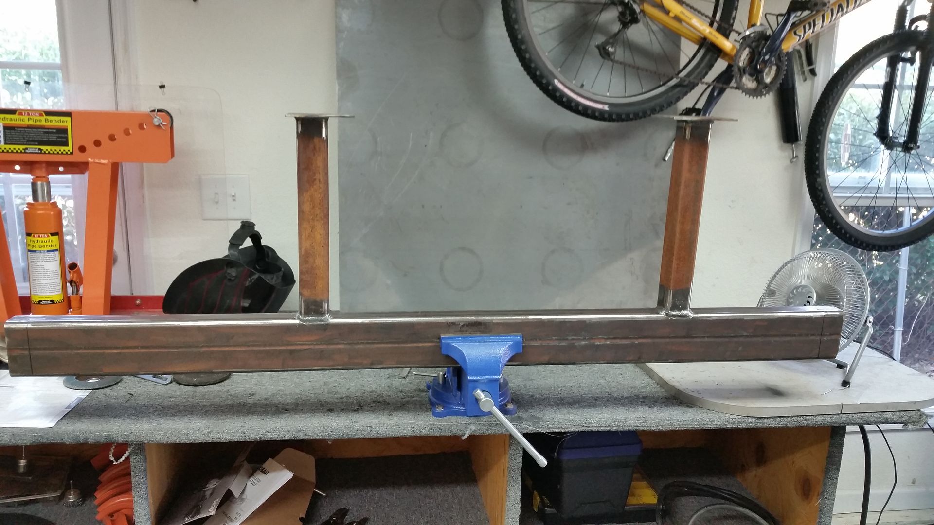

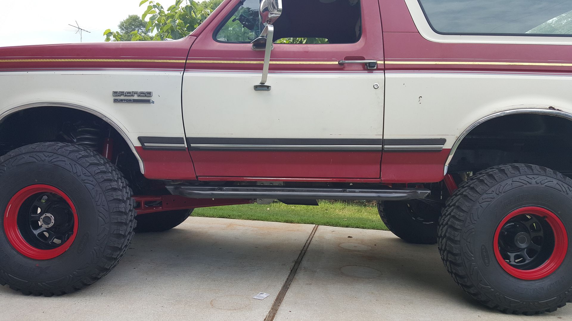

Here is My setup.
The "Step Slider" rails are 3" x 6" x 1/4" & 65 1/4" long
w/ Full Penetration welds and Yes, they will hold air.
The Standoffs,
6 pcs. of 3" x 3" x 1/4" tube for standoffs and
12 pcs. of 6" x 6" x 1/4" Plate for mounts & backing.
The Steps
The steps were measured 25" from Front Edge to the center of each step & are 4" deep.
they are 16" wide at the door sill & 18+" wide at working edge with 6" radius added for the "rounded" look.
We added 1/4" Diamond plate onto the top of the step cut out for traction & added strength. (Full 1/2" thick)
The ends were setup with a 3" radius for the outside corners,
1" drop at ends then 3" from end to establish the bottom of the angle.
they did pass the 1st test with flying colors.
These things are Heavy but It's so much easier to get in now
and with the 6" lift on 35's and nothing hanging down / out
to get hung on rocks I think they will do O.K.
They still need field trials to see how the step detail actually holds up.
Now just to get back out "on trail"...
