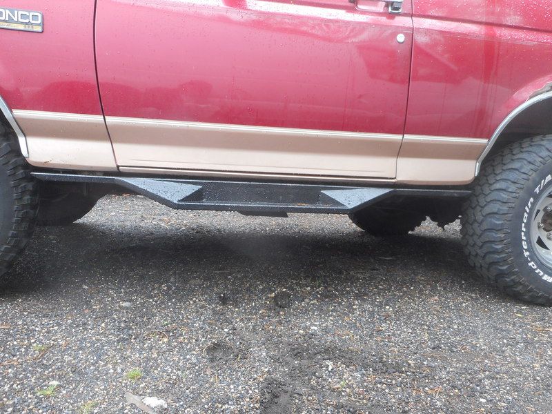

Here is My setup.
The "Step Slider" rails are 3" x 6" x 1/4" & 65 1/4" long
w/ Full Penetration welds and Yes, they will hold air.

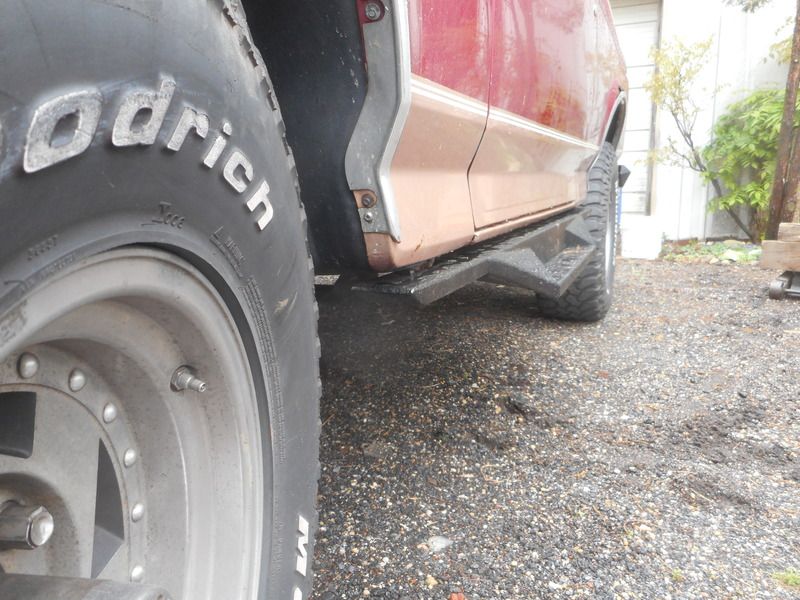

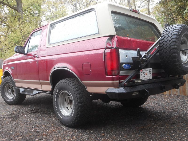

Here are mine. I wasn't sure about the kicker at first. I haven't used it as a kicker yet but I sure do use it to get stuff out out of the back and it helps cleaning the roof.

Did you make those rock slider steps? If not will you tell me where you got them?
Thanks
They were made by a private individual and no longer for sale. I have a set I purchased, same as these from the same run, for sale.
edit. My bad. I have these for sale. I thought this was on the other thread you posted in about the shifter.
